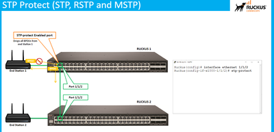

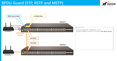

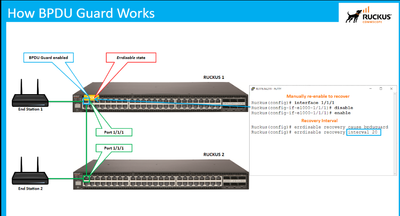

Securing Networks with STP Protect and BPDU Guard
STP Protect is designed to enhance network stability by causing a port to drop STP BPDUs originating from the device connected at the other end of the link. The primary function of this STP protection is to prevent end stations from either initiating...

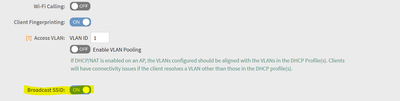

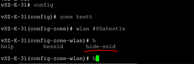

Hide SSID on vsz / sz
 As a Ruckus TAC engineer, I would like to share a knowledge article about how to hide the SSID on smart zones.We can access the option to hide the SSID from the controller's GUI and CLI. Hide SSID from Controller GUI: In controller GUI we can access...

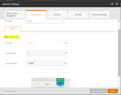

AP LAN Port option greyed out
As a Ruckus TAC engineer, I would like to share my experience with some AP model with Single LAN port AP( for example R350) where option to change the untagged VLAN ID on AP LAN port is greyed out on Ruckus cloud GUI. We can see that even when the e...
