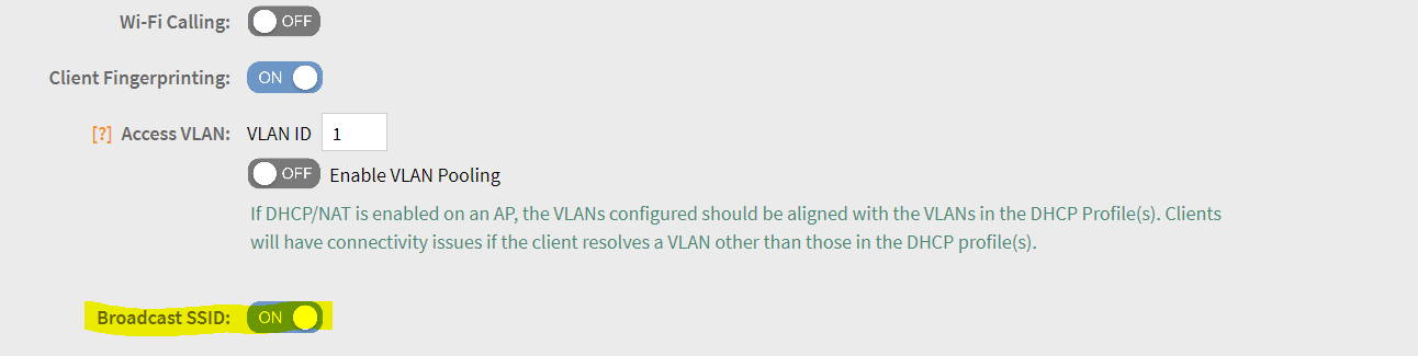

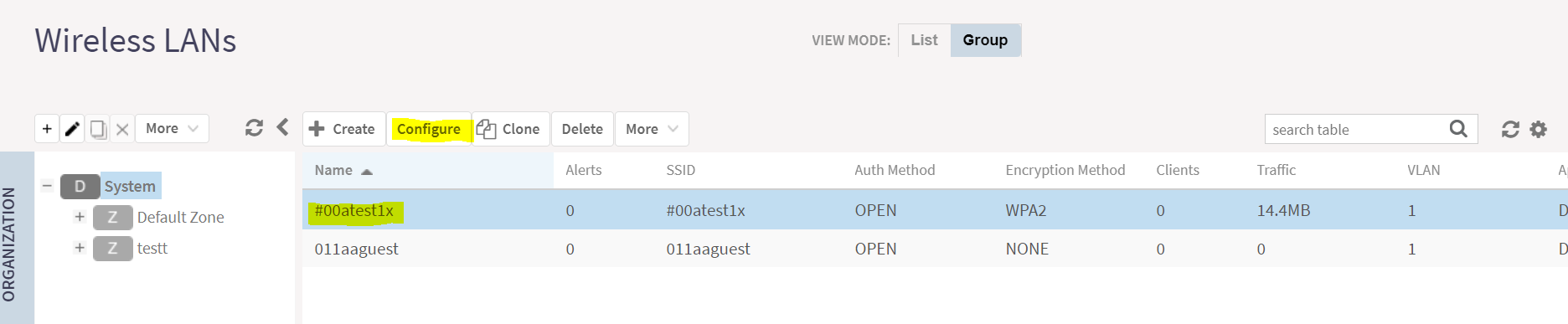

In controller GUI we can access the option under below path:
Wlan >> (select wlan) >> configure >> Advance options >> Broadcast SSID
To hide the SSID, we must disable this option, and to enable SSID, we must enable it.

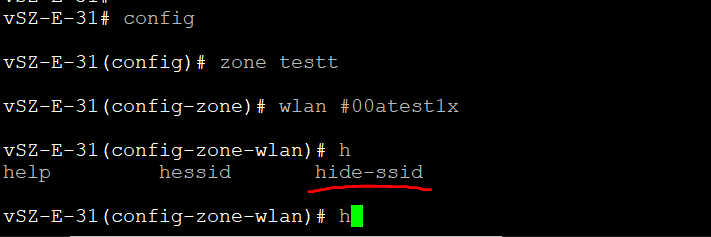

Hide SSID from Controller CLI:
Similarly, we can access the option via the controller CLI with the following commands:
vSZ-E-31(config)# zone <zone name>
vSZ-E-31(config-zone)# wlan <wlan name>
vSZ-E-31(config-zone-wlan)# hide-ssid
Below is the example form my controller:
