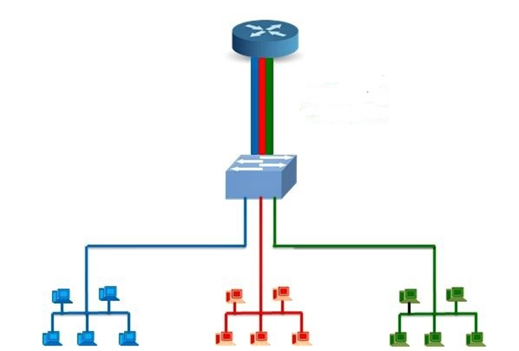

But in a setting of the organization: where all users use the common LAN: this can be done in the below manner.
Suppose the network layout is as below [it is usually more complicated than this ]: where we have the core layer or device where all traffic aggregates/converges be it going out to the internet or coming into the site from the internet.
Courtesy Google Images.
That’s usually the core router or the multilayered switch that’s designated as the core router.
Here, the implementation of a QoS policy for marking needs to be done for the above-mentioned range of TCP/UDP ports to those DSCPs.
Once this is done: on the subsequent downstream devices [ switches ]: the incoming traffic needs to be trusted for dscp for the markings to be honored.
