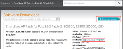

Recently we have come across several queries if we can upload 3.6.2.X AP Patch on SZ-144 or any other controller running the 6.1.1.0.595 version.
Query: Can we upload 3.6.2.X AP Zone firmware on SZ-144 running 5.2.2.X or 6.1.1.X?
Answer: Yes, we can manage the 3.6.2.X AP Zone version on SZ-144 running 5.2.2.X and 6.1.1.X.

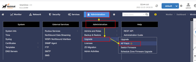

In order to show the AP patch upload procedure, I have taken SZ-144 running on 6.1.1.0.959 firmware and the AP patch version as 3.6.2.x AP:
Login to the controller GUI --> Administration --> Upgrade --> AP Patch --> Browse the File (patch downloaded) --> Click Upload :-
Once the AP Patch is uploaded (from step2), the “Apply Patch” button gets highlighted (as shown below):

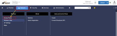

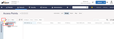

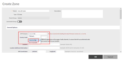

Once the Patch is applied to the controller, it is time to apply the patch to the existing AP zone or to create a new AP zone with that applied AP patch.
I have shown how to create a new AP Zone using the applied AP patch version:-
