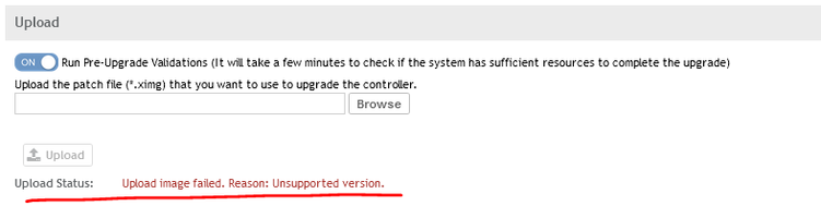

Check this KB for "Upload image failed. Reason: Unsupported version."

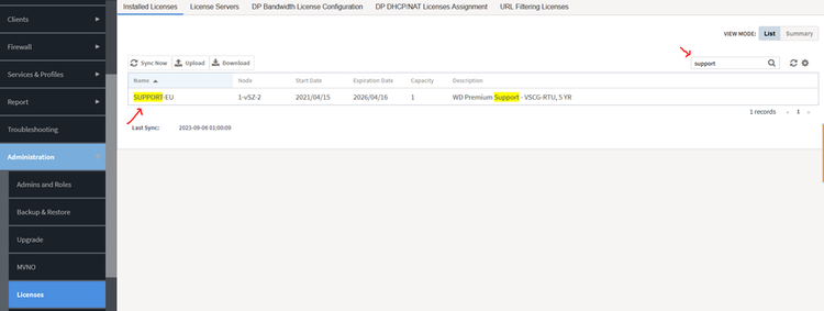

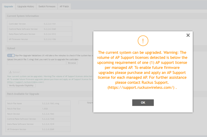

1. Make sure you have an active support license. The Support License is required for the upgrade. Get in touch with your sales team if you need to renew/buy a license. Tell me more.

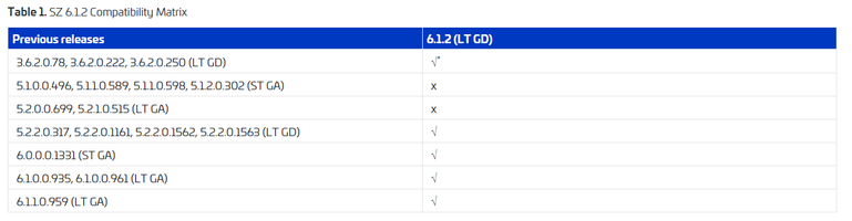

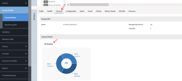

2. Check that all the AP models in the controller will be supported in the target version -or at least on a 'legacy zone'-. You can verify the AP model compatibility matrix with the target version of the controller in the Release Notes file for the corresponding version. You can learn more about that in this excellent KB. Also verify the number of ‘online’ APs so you can double-check the same once the upgrade is completed.

4. Verify if any upgrade path through intermediate versions is mandatory. This can also be learned in the Release Notes file. Check this KB. In summary, these paths are permitted:
  • 3.6.2.x >>> 5.2.2.x
  • 5.2.2.x >>> 6.1.x

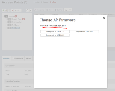

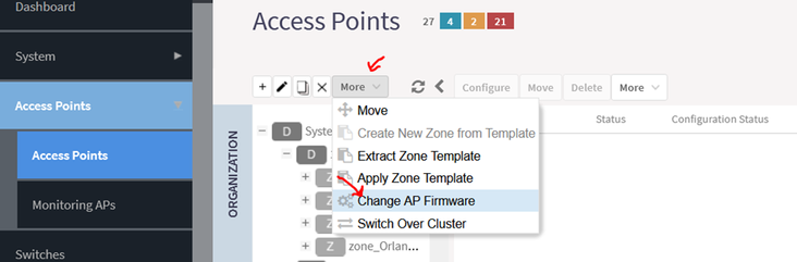

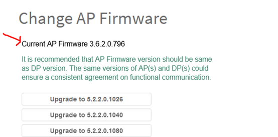

5. Check all the AP Zones have a permitted AP firmware. If AP Zones have unsupported AP firmware, the upgrade validation will fail before the upgrade can be started. Simply move the AP Zones to the appropriate firmware. You will learn which AP firmware is supported in the target version using the Release Notes file of the target version (check this KB).
How to upload the required AP firmware?

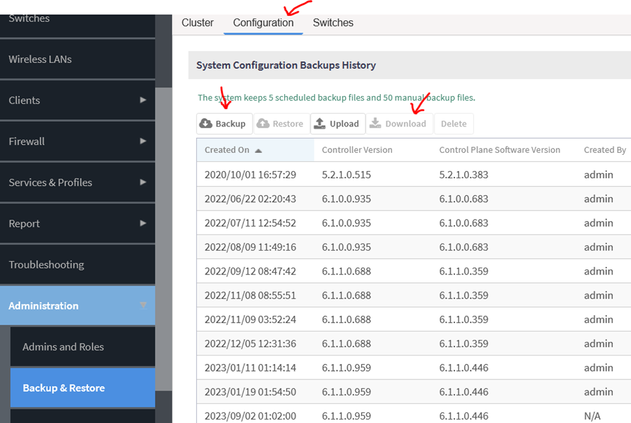

6. Create a configuration backup of the controller and download it to your PC .

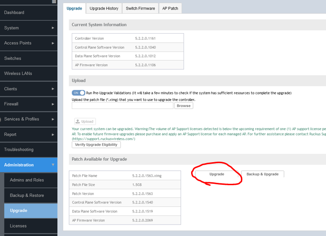

7. Initiate the upgrade of the controller.
Once the file has been uploaded, 'Firmware Eligibility' will be auto-triggered and it will show a warning if something is preventing the upgrade.
However, if everything is correct, this warning will be shown: You can just click ‘OK’ and continue further.
Why is this warning telling me this?

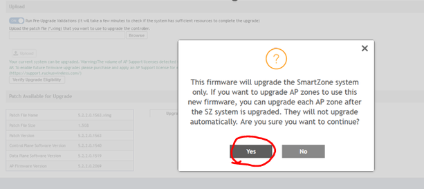

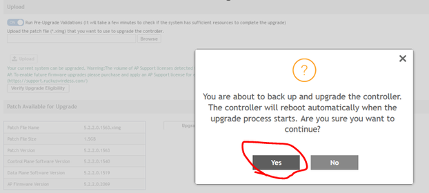

Click ‘Upgrade’ if you have the configuration backup already saved in your computer:
There will be a prompt saying "the upgrade of the AP Zone must be done separately", just click ‘Yes’.
Finally, one more prompt saying "the controller will reboot to complete the upgrade". Click ‘Yes’.

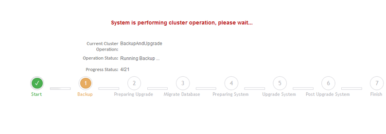

Then, the upgrade process bar will appear. (Starting from here, it might take up to 60 mins for all the services to be online and fully operational)

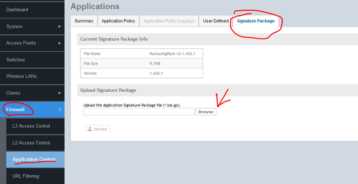

* What is the application signature package? It’s a file that helps the Access Points identify applications used on the internet. It’s mostly for security purposes when specific firewall policies are configured. It’s optional but recommended to update this file to the appropriate version of the newly installed version. Verify the RUCKUS v/SZ Upgrade Guide to learn more about this.
Is the upgrade of the sigpack failing? Just skip this task and attemp the upgrade after the controller is on the newer version.
