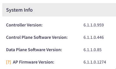

I am getting the below error message when trying to upload 3.6.2 or 5.2.2 patch to client's vSZ144 controller.
Upload patch failed. Reason: Upload AP patch general error. Fail to sync AP patch
Controller is running following version:

dawidku
New Contributor III
OK mistery solved.
I have downloaded my files from the same location from Support Portal but seems I had them already in my downloads and those recently downloaded were renamed as you can see below
So uploading these files with changed name caused the patch process to fail, simply renaming the files to remove bracketed numbers resolved the issue.
Sort of a bag I would say but anyway I am glad I got to the bottom of it and patched the controller.
