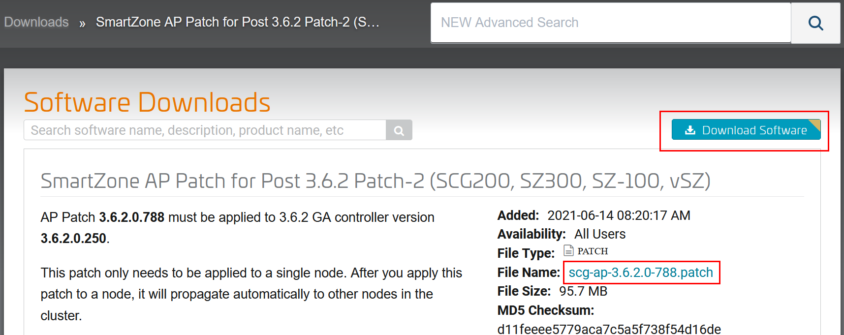

- Download the 3.6.2 AP patch from the Support Portal link below:-

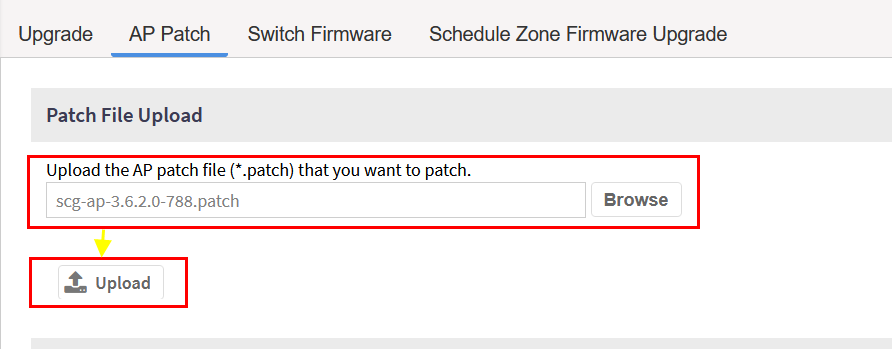

- Upload the AP patch:-

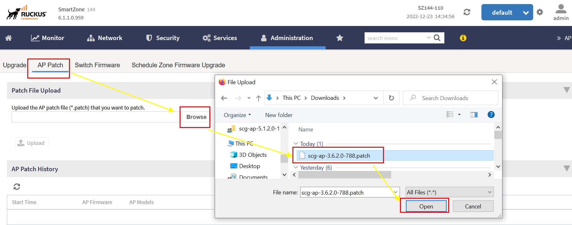

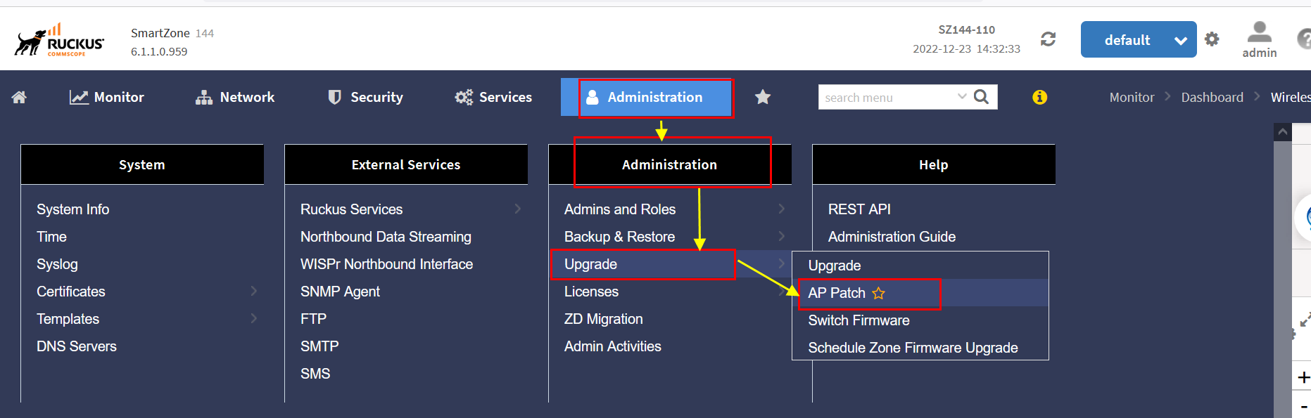

Login to the controller GUI --> Administration --> Upgrade --> AP Patch --> Browse the File (patch downloaded) --> Click Upload :-

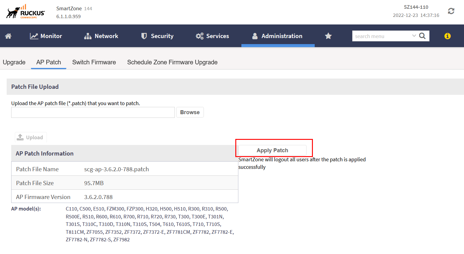

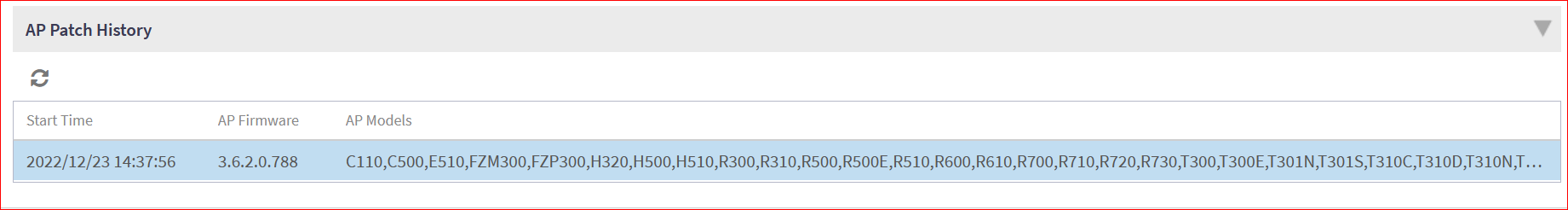

- Apply the AP patch:-
Once the AP Patch is uploaded (from step2), the “Apply Patch” button gets highlighted (as shown below):

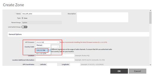

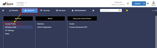

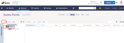

- Create a New AP Zone with the AP patch version running 3.6.2.x:-
Once the Patch is applied to the controller, it is time to apply the patch to the existing AP zone or to create a new AP zone with that applied AP patch.
I have shown how to create a new AP Zone using the applied AP patch version:-
