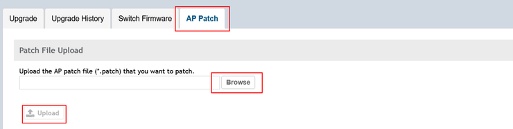

You can add this AP firmware version with the AP patch for this purpose:
You can download the 3.6.2.0.795 patch HERE
- Upload the AP patch at Administration>Upgrade>AP Patch

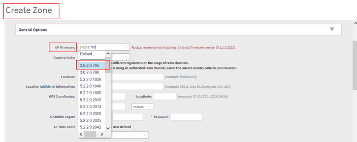

- Create a new AP zone and select firmware 3.6.2
