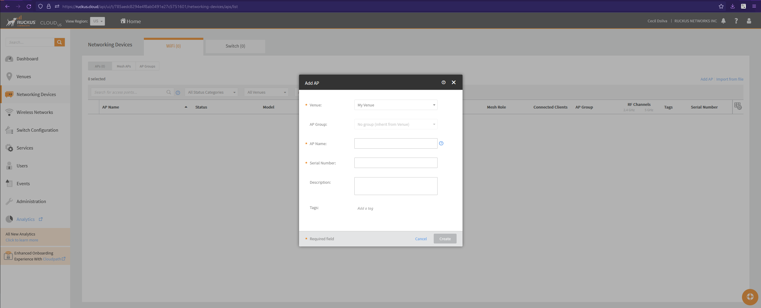

- Add the AP serial number to the Ruckus Cloud Dashboard at https://ruckus.cloud > Networking Devices > Add AP

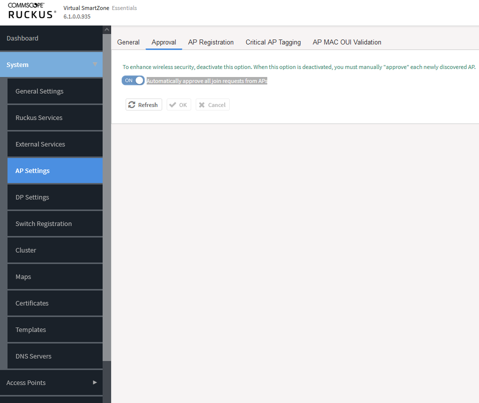

- Head over to System > AP Setting > Approval – disable the “Automatically approve all join requests from Aps” toggle and hit OK
- This prevents the AP’s from coming back to the SZ after the migration

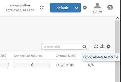

- Head over to Access Points > select the Zone which has the AP’s parked and on the far right look for the “Export all data to CSV file” option
- This will be the list that we can use in case of a failure to manually move any AP’s that are stuck due to network conditions

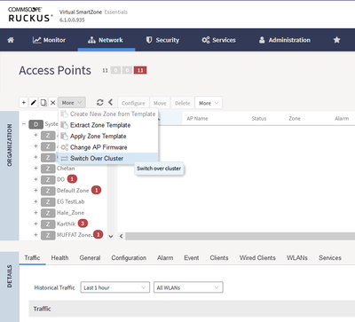

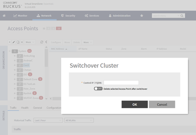

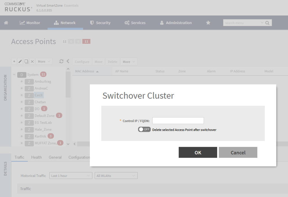

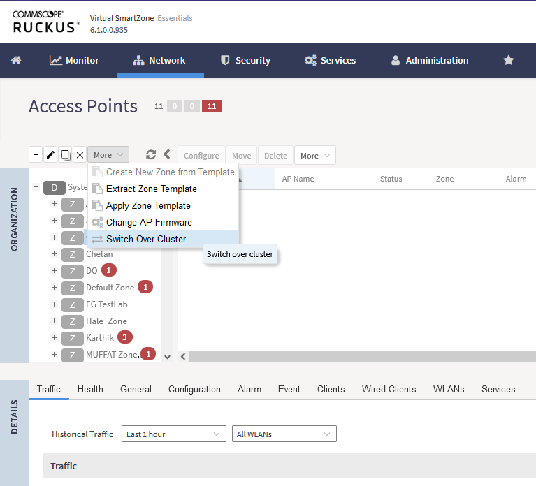

- Select “More” from the drop down just above the Zone names and select switch Over Cluster
- Feed in the Server IP we fetched from Step 2 and make sure to enable the “Delete Selected Access Points after switch over” toggle
