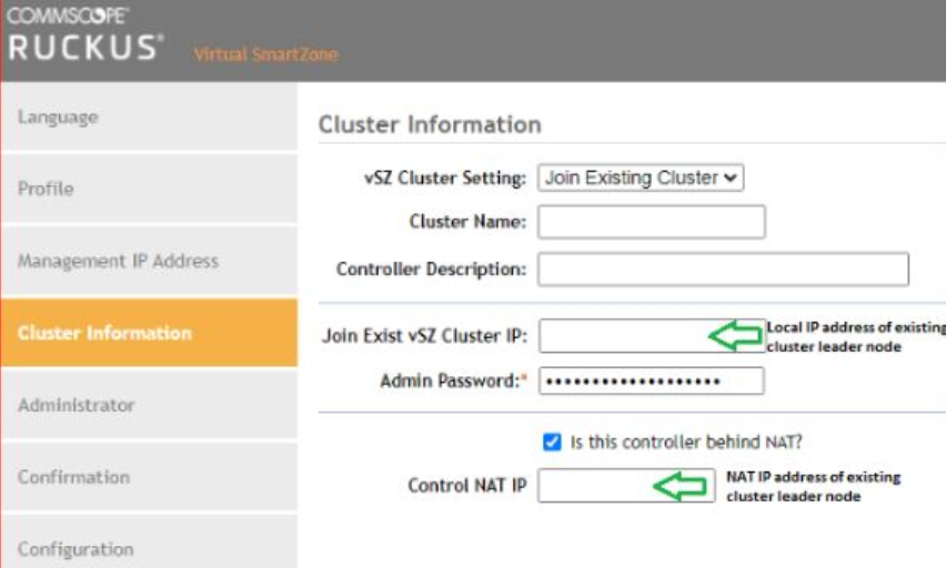

This is the configuration you should use when setting up the 'Join an existing cluster' procedure:
