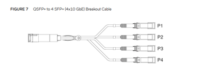

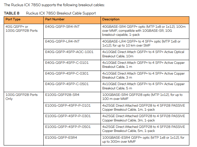

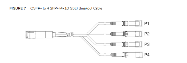

Breakout cables ICX7850
Example breakout cable 40g ports

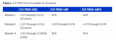

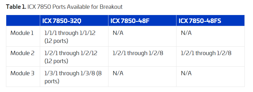

Breakout ports available for each ICX7850 model
