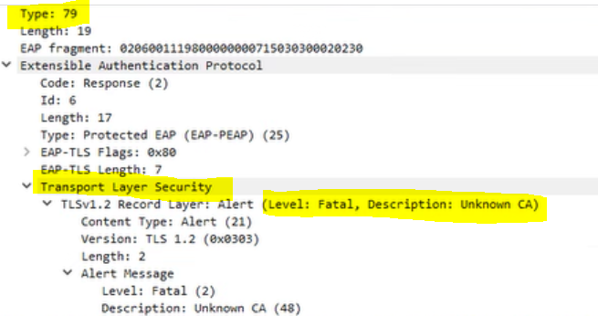

When working with RADIUS, Network Policy Server (NPS), and implementing DOT1x authentication using EAP-TLS, you might encounter an error message in the packet capture stating "Unknown CA." This error typically occurs when the certificate authority (CA) responsible for issuing the server's certificate is not recognized or trusted by the client.
Symptom:
- Computer fails to connect to the dot1x wireless network.
- Taking a packet capture on the interface of the NPS server, an "Unknown CA" error is seen in the RADIUS Access-Request packet sent to the server during the authentication process.
