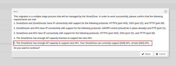

Pre-requisite :
• SZ and ZD have reachability to each other. AP can reach SZ and AP models should be supported by SZ.
• Make sure the Administrator Name/Password is set to Authenticate using the admin name and password – disable Authenticate with Auth Server if enabled.
• Under Configuration / System make sure that login Warning is disabled.
• Under Configuration / System make sure if using Management Access Control either disable or add the vSZ IP address to the list.
• Make sure we are using control IP of the vSZ to connect.
• Make sure that the TFTP (69), HTTPS (443), FTP (21) and SSH (22) is allowed between the vSZ and the ZD.
• The password we use for the ZD is matching the vSZ's password security rule.
• Make sure preferred authentication method is not AD or Radius.

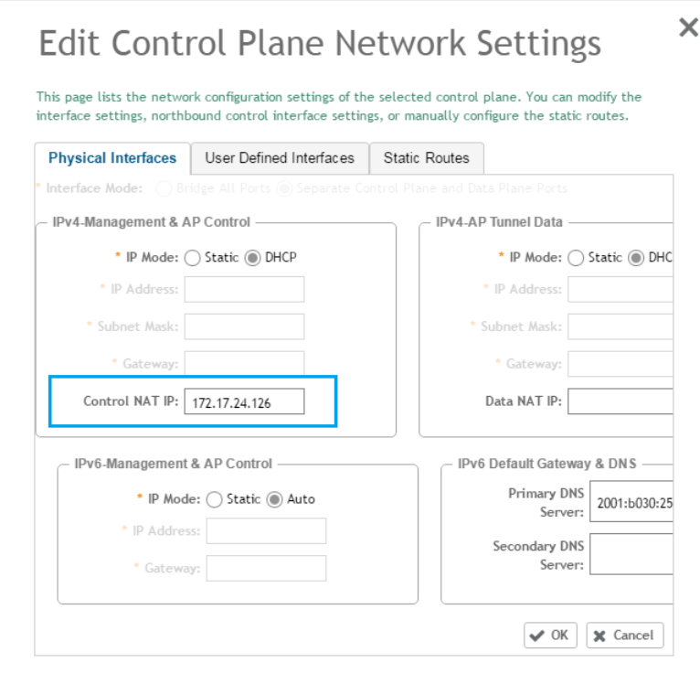

ZD to SZ migration supported behind NAT as following :
• SZ, ZD, and APs are all on same local subnet
• SZ and ZD are on same local subnet at Site1, APs are on different site, across a WAN boundary.
• SZ is at Site1 behind NAT with port translation from public IP. ZD and AP are on site2 behind NAT
• Configure NAT setting on vSZ :

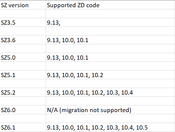

Supported ZD to SZ migration code :

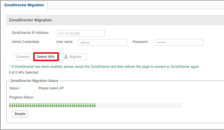

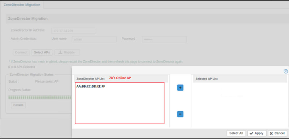

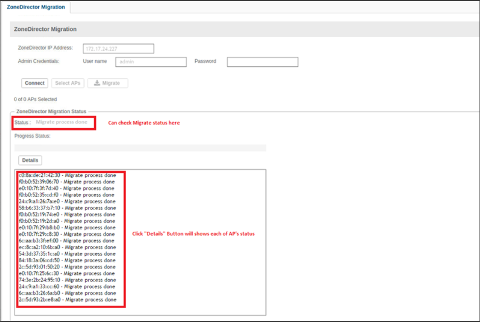

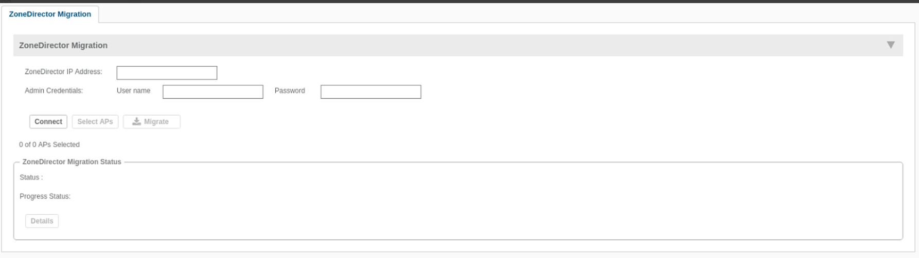

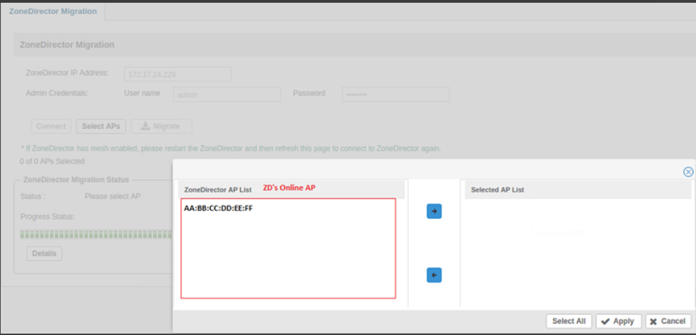

UI Process:
1) Administration > ZD Migration
2) Connect ZD → Select AP → Apply AP → Migrate button will be enabled after Apply
