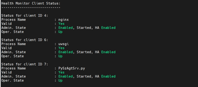

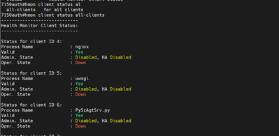

2: The next 3 processes nginx, wmsgi and PySzAgtSrv.py must be Oper. State: Up and can be checked with the next command: hmon client status all-clients, However if the processes are down, we recommend ensuring the IMAGE you are using is UFI if not, upgrade to the UFI image, however if the image is UFI already, we require performing a reload or a factory reset in case the issue still persisted after reload, but if the issue persisted please contact our TAC team.
Working
No working:
