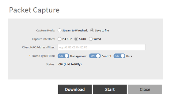

Collect a packet capture on the specified wireless interface of the AP by selecting the AP and then click 'More'>Packet Capture.
In the Packet capure page, select the appropiae radio you want to monitor and the option 'save to file'. Click 'Start' to begin to capture and then 'Stop' to stop the capture. When the file is ready, the 'Download' option will appear for you to download the file.

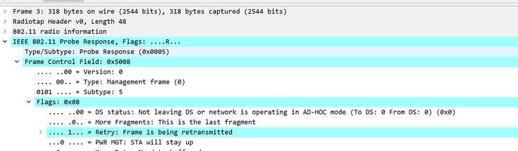

Once you have got the pcap file, then you can look for the 'Retry' flag on the 802.11 information of the frame.

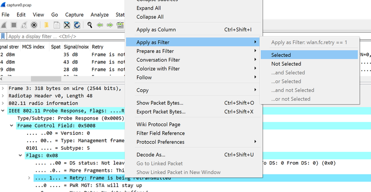

Right click and 'Apply as Filter>Selected to fiter out the all the retransmitted frames:
This is the wireshark filter for the retry flag in the frames.
wlan.fc.retry == 1

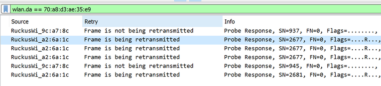

Check the total amount of packets in the file vs. the number of packets displayed and then you will have a meassure of the retransmission rate of the packets captured in the specific lapse. In our example, we have a 10% of retransmission rate.
We can see, for our example, the probe response from the AP was retrasmitted many times, which means -most likely- the client never received it. This could have ended on a client unable to connect to the wireless network or maybe just connecting to the next available AP -no usually the closest one-.
