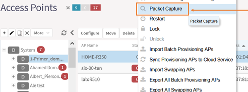

- Access the SmartZone's web user interface.
- Navigate to the specific AP for which you want to capture packets.
- In the AP settings, find the option to initiate a packet capture on the AP radio.
- Start the packet capture from the AP radio. Ensure that it captures data from all traffic types simultaneously. (Management, Control and Data)

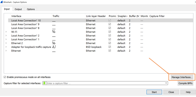

- Before starting the capture, navigate to Capture > Options.
- In the 'Capture Options' window, click 'Manage Interfaces'.
- In the 'Manage Interfaces' window, go to the 'Remote Interfaces' tab.
