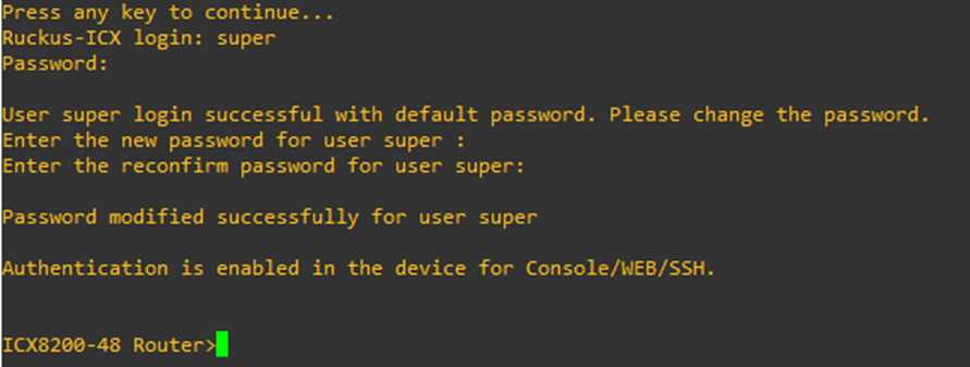

username: super
password: sp-admin
Then, you will be able to create a new password.

7- The swill will boot up and it will ask for default credentials.
username: super
password: sp-admin

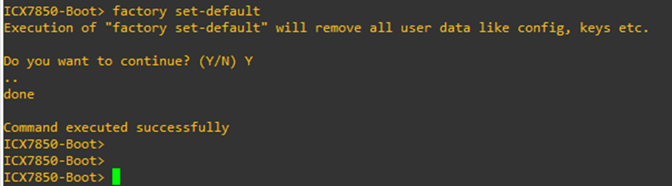

Today I faced a similar issue with ICX 7150 code 08095 and I tried the above steps that you mentioned but had no luck.
You can refer the below screenshot for your reference :
As you can see from the above screenshot once I run the command factory set-default it gives an error as "aborting operation " if I boot the ICX it still asks for Creds.
Then I tried with the command "use default-configuration" and then "boot" then issue got fixed.
Thanks

This can happen if you enter "y" lowercase, then you get the message: Aborting operation
As soon as you enter "Y" uppercase, the message you get will be: Command executed successfully
