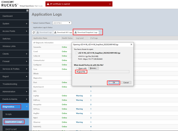

If no alarms or events are generated on the controller and the AP is not listed in the SZ web GUI, we need to check the vSZ/SZ Snapshot log.

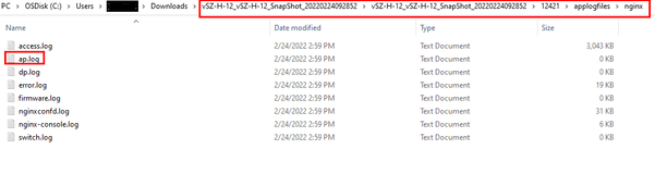

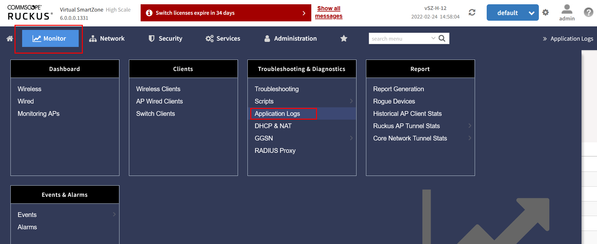

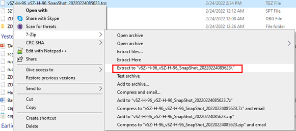

B. On the SZ side:
applogfiles -> nginx -> Access.logs and error.log. (Steps shown in the screenshots below)
NOTE: In SZ/vSZ 6.0 and above, the file name is ap.log.
Screenshot from vSZ 6.0 snapshot:

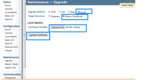

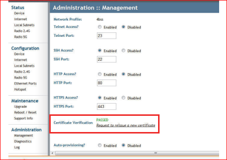

B. Update the certificate locally in the AP:
Note: This usually reboots the AP. If it doesn’t, manually reboot the AP by going to Maintenance, then Reboot/Reset, and click Reboot Now.
