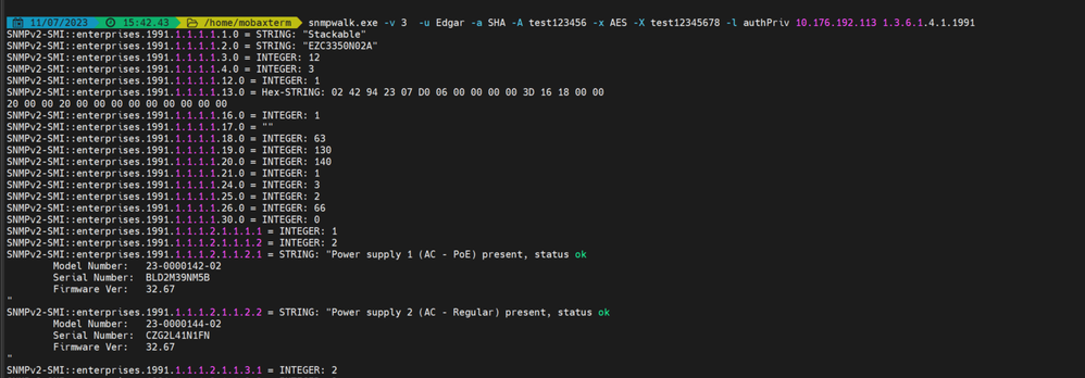

Now we can run the snmpwalk in MobaXterm:
First make sure you have installed the net-snmp services in MobaXterm
snmpwalk.exe -v 3 -u Edgar -a SHA -A test123456 -x AES -X test12345678 -l authPriv 10.176.192.113 1.3.6.1.4.1.1991
Here is the command syntaxis
snmpwalk -v3 -u <username> -a <auth_protocol> -A <auth_password> -x <priv_protocol> -X <priv_password> -l authPriv <target_host> <oid>
