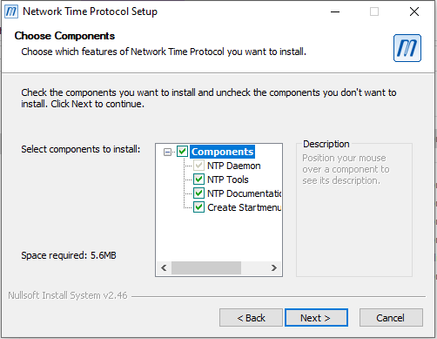

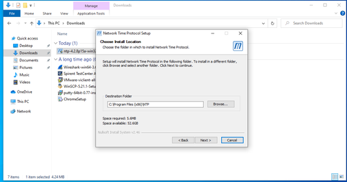

1-Download the app, proceed with the installation, and then open it.
https://www.meinbergglobal.com/english/sw/ntp.htm
2-Proceed by clicking "Next" until you get to the configuration section.

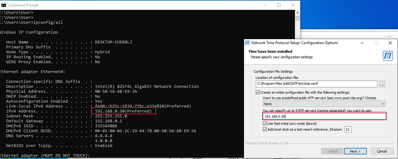

3-In the configuration state, you have the flexibility to employ multiple NTP server domains or IP addresses. For this particular scenario, will use the IP address of a local machine directly connected to the ICX-8200, simulating an air-gapped NTP server.

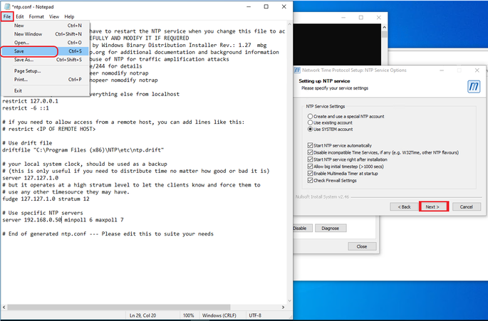

4- After clicking "Next," a configuration file in Notepad will open, displaying the current settings, which can be customized according to your preferences.

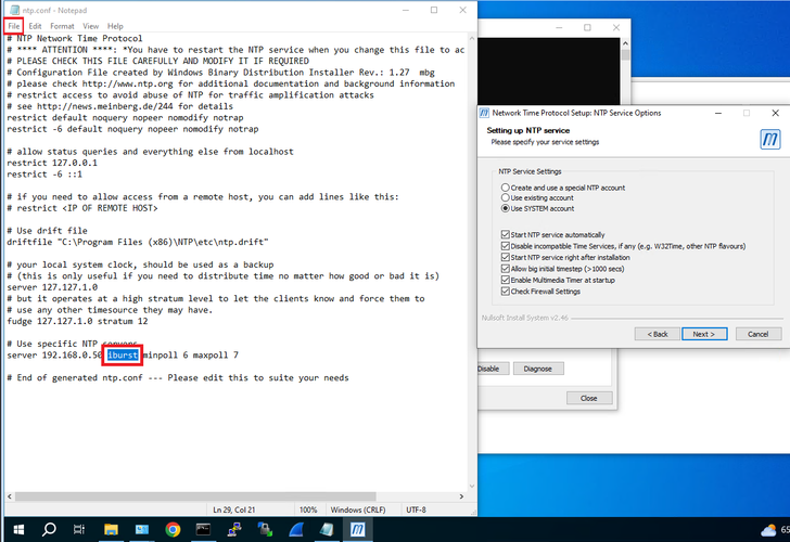

To ensure compatibility with certain devices that do not support it, we need to remove the "iburst" option from the configuration file. Once the modification is made, save the file.
Note:The remaining options will be left at their default settings but feel free to edit them as per your preferences.

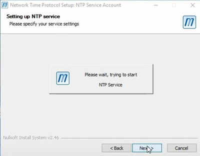

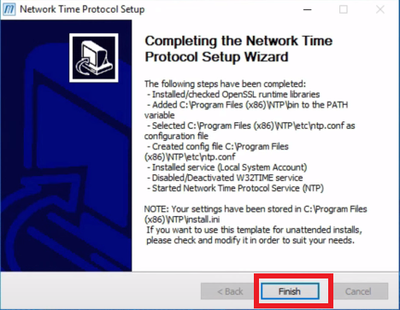

5- After selecting "Next," the NTP server will start automatically, requiring no further action. Simply proceed by clicking "Finish" to complete the process.

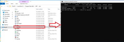

6-To check the status of the NTP server, you can navigate to the installation directory where it is located.
In this case is located in C:\Program Files (x86)\NTP\bin

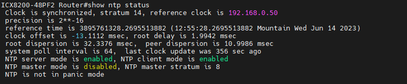

After a brief synchronization period, we can confirm the status by executing the command:
show ntp status - show ntp associations
Note: Make sure your Switch is on the correct time zone
