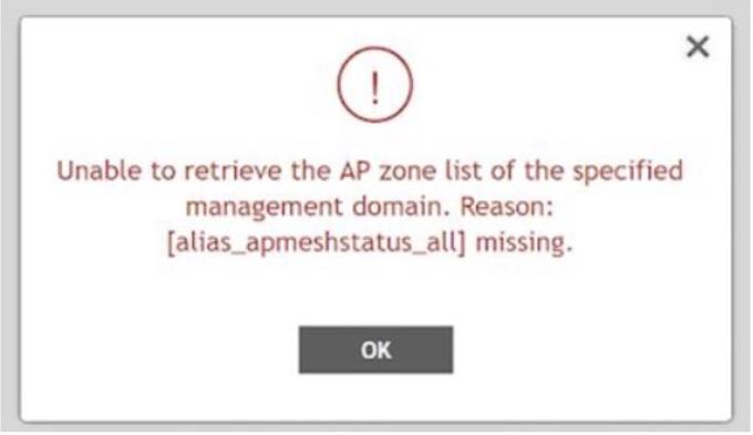

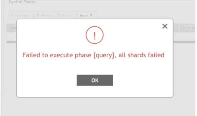

Issues that you will notice on UI:
Pop-up error messages about ES keywords (For example: "all shards failed")
Pop-up error messages about "alias missing"
Show no result in WebGUI (For example: WLAN tab or AP tab show no result)
AP Traffic column or radio (2.4 or 5GHz) column would show N/A.
And sometimes, navigating between different tabs of the controller you would see “An Unknown error” occurred message.

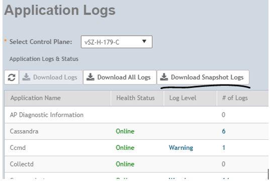

How to identify from the logs if ES has gone bad?
Download Snapshot logs from the SZ/vSZ, by navigating to Diagnostics > Application logs
Configurer/configurer.log

Caused by: org.elasticsearch.indices.IndexMissingException: [alias_apmeshstatus_all] missing
at org.elasticsearch.cluster.metadata.MetaData.convertFromWildcards(MetaData.java:884) ~[elasticsearch-1.7.2.jar:na]
at org.elasticsearch.cluster.metadata.MetaData.concreteIndices(MetaData.java:692) ~[elasticsearch-1.7.2.jar:na]
at org.elasticsearch.action.search.type.TransportSearchTypeAction$BaseAsyncAction.<init>(TransportSearchTypeAction.java:118) ~[elasticsearch-1.7.2.jar:na]
at org.elasticsearch.action.search.type.TransportSearchDfsQueryThenFetchAction$AsyncAction.<init>(TransportSearchDfsQueryThenFetchAction.java:76) ~[elasticsearch-1.7.2.jar:na]
Web/web.log
Web[localhost-startStop-2] ERROR c.r.s.d.s.r.ReIndexServiceImpl - init reindex [com.ruckuswireless.scg.domain.service.reindex.APReIndexCommand@47dda78] failed
