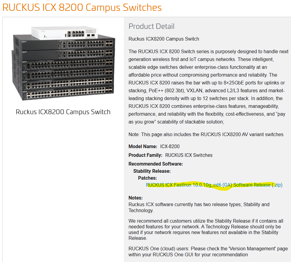

Have you ever wondered what code Ruckus recommends you run on your ICX? You are in luck. Each product support page has a built-in recommendation or recommendations. While these recommendations will not cover every scenario or customer, it should be your starting reference when selecting code for ICX devices. The recommendations are updated occasionally and will change over time. We recommend most customers look to our Stability Release if it contains all needed features for your network. As always, you can contact us if you are unsure where to start.
To find the recommended code, navigate to:
https://support.ruckuswireless.com/product_families/21-ruckus-icx-switches
On the above page, you can see the recommendations for all active models and it will contain a direct link for our recommended code. If needed, you can select the appropriate model to get to additional downloads, documents, etc (ex. ICX8200 Support Page).
I have attached a screenshot from our ICX8200 page highlighting the recommended code field.
NOTE: RUCKUS One (cloud) users should look to the recommendation in their respective web GUI. The recommendations here are generally for non-cloud customers.
