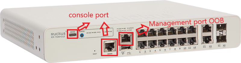

  1. Console the Unit:
    • Connect to the unit via a console cable and monitor the boot process. Interrupt the boot process by pressing b at the boot counter.

  1. Set Up for Recovery:
    • Connect an Ethernet cable from the management port to the TFTP server.
    • Ensure the device is in boot mode for recovery.
