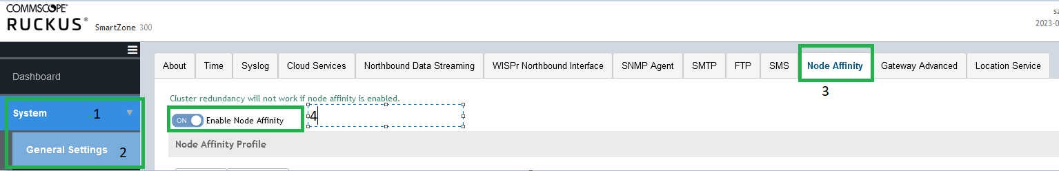

- Navigate to System>>>General Setting>>>Node Affinity
Enable Node Affinity- ON

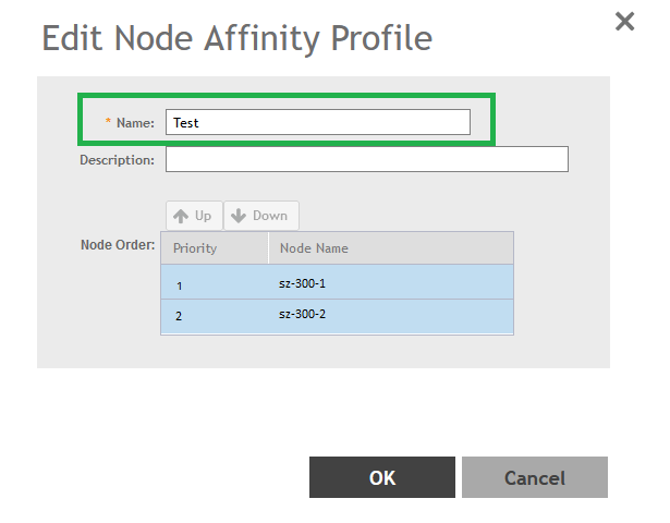

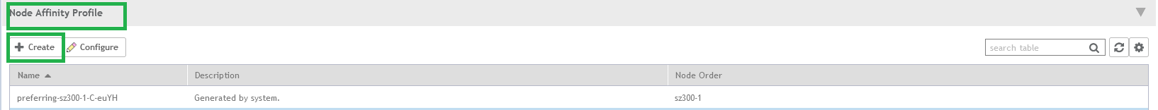

Once Node affinity is enabled, create Node Affinity Profile.
- Click on Create under Node Affinity Profile, to create a profile
1: Name the Node Affinity Profile.
2: Select the node order to set priority of the available nodes based on requirement.

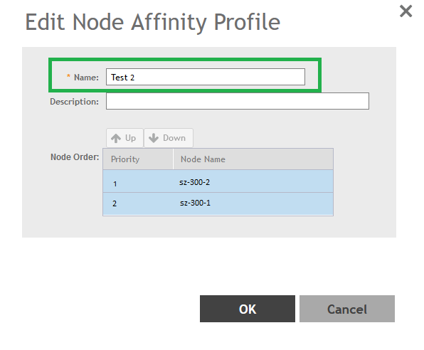

Similarly create another Profile and reverse the order of Node Priority.

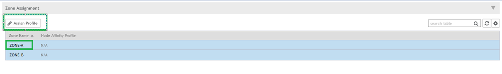

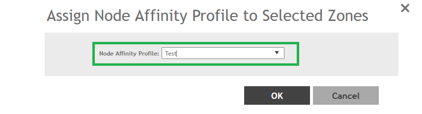

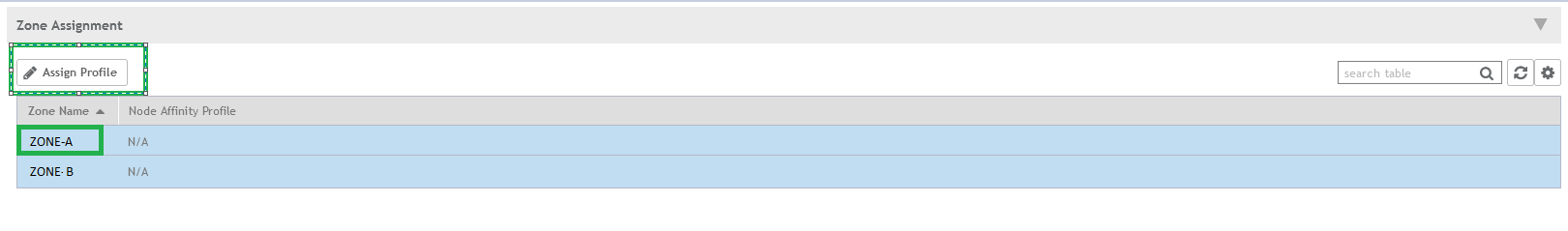

- Under Zone Assignment in the same page select zone and click on Assign Profile.
Select the node affinity profile created in the previous step.

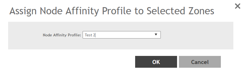

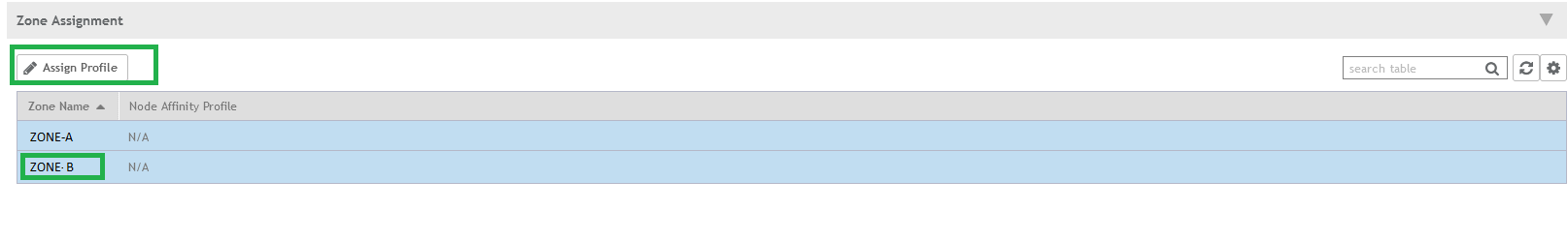

Similarly map another Profile on the second zone.
Based on the priority configured on the profile, ZONE-1 AP will prioritize sz-300-1 as the primary SZ, and ZONE-2 AP will prioritize sz-300-2 as primary SZ.
