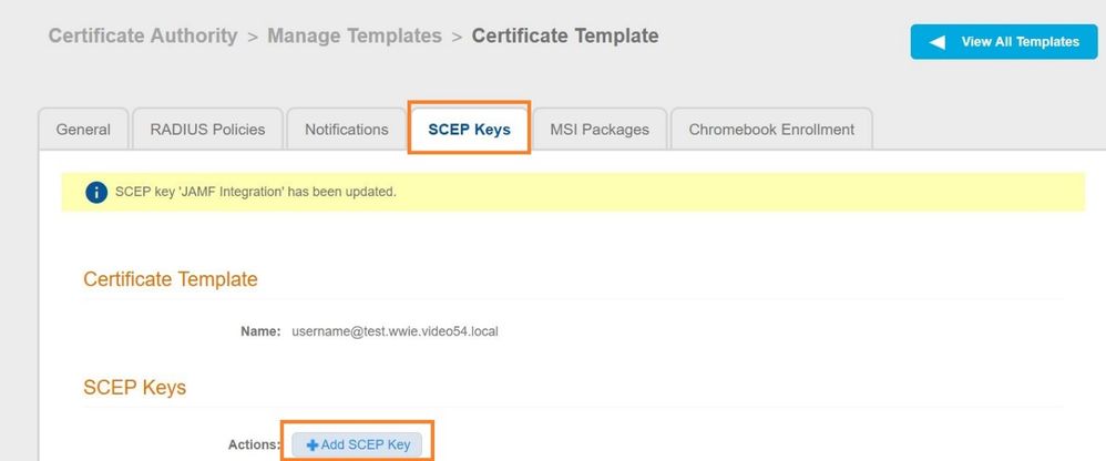

Create a SCEP Key

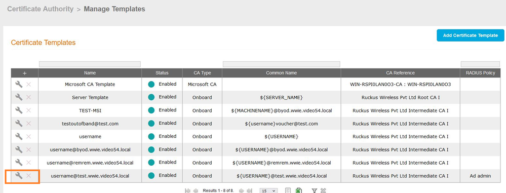

In the Cloudpath admin user interface, go to Certificate Authority>>>
Manage Templates, then select the Certificate Template that will be used to issue the user/device certificates to the JAMF managed devices. Click on the “Manage” icon for the certificate template.

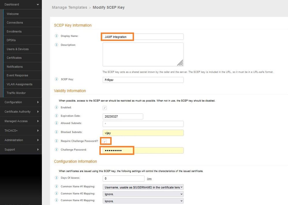

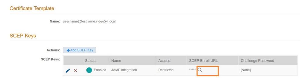

Select the SCEP Keys tab and under SCEP Keys , click on the “Add SCEP Key” button.
In the “Create SCEP Key” page, set a display name and description for the SCEP key. Set an expiration date if required. Select “Require Challenge Password” and enter password. Leave the Configuration Information section at the default settings. Click Save.

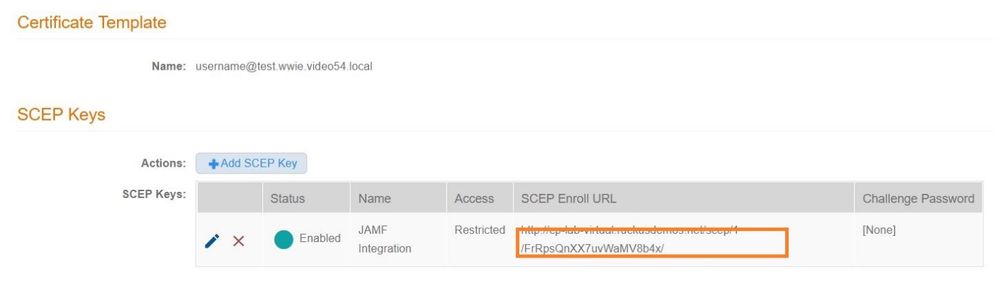

Back in the SCEP Keys tab of the certificate template, click on the “Show” icon under SCEP Enroll URL column.
This will reveal the full SCEP Key URL. Copy the full SCEP Enroll URL to a text editor (Notepad) for later use.

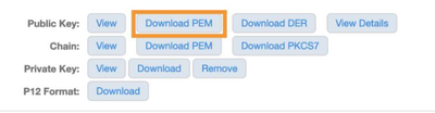

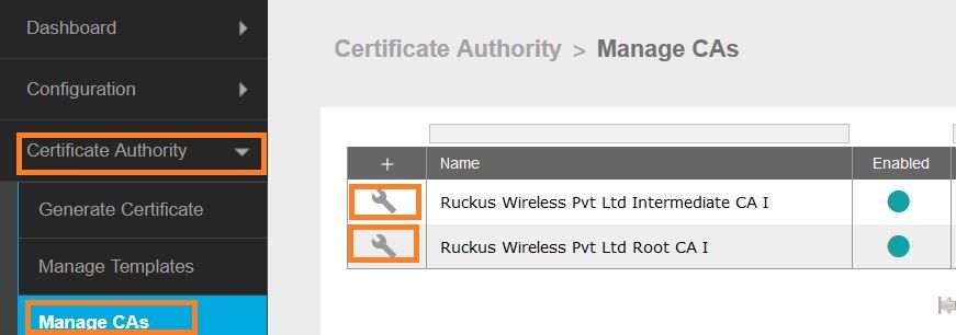

To export the CA certificate, go to Certificate Authority>>>Manage CAs. Expand the Root section.
In the Public Key section, click on the “Download PEM” button. This will download a Base64 encoded DER file.
Perform the same steps for the Intermediate CA certificate

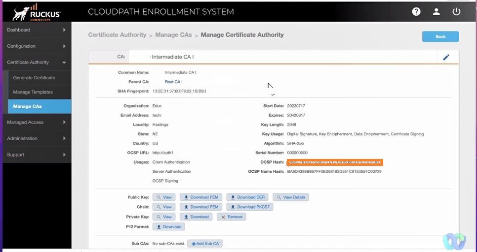

Get OCSP hash from Intermediate CA, it will be used in JAMF config later.

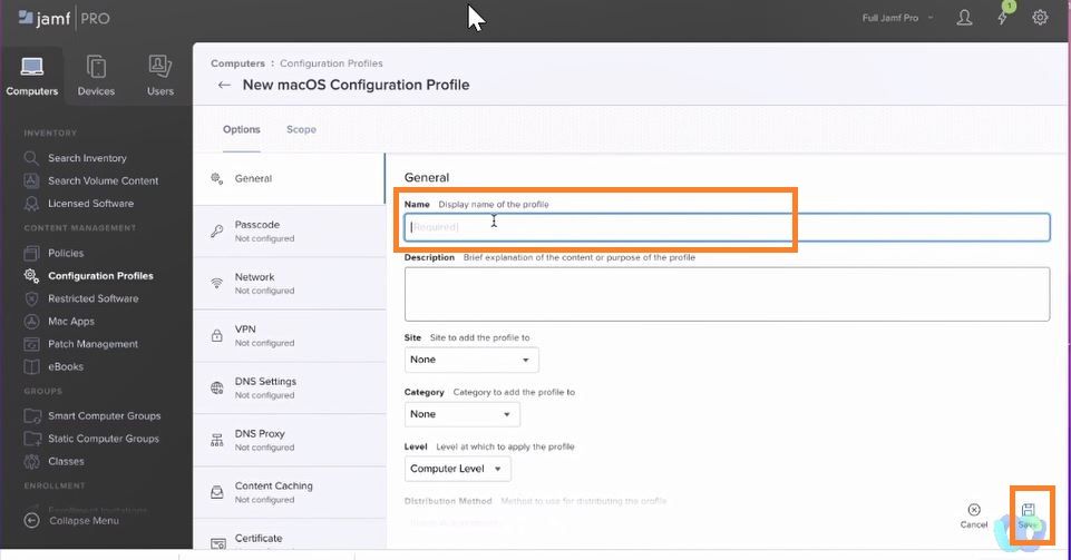

Login into JAMF select Configuration Profiles>>>>New
Name: Name the profile and Save.

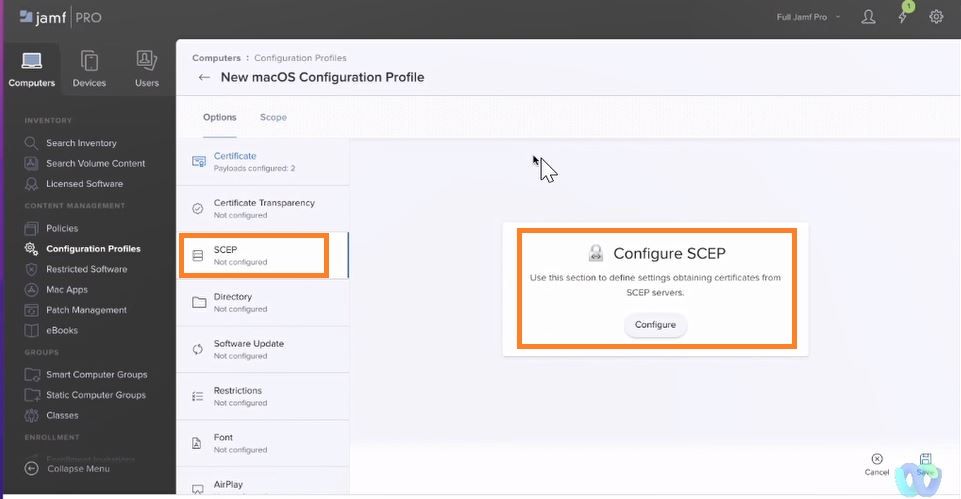

SCEP SETTING

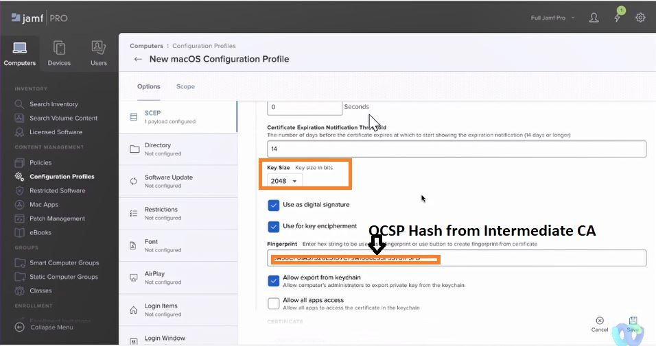

SCEP>>>Configure SCEP.
URL: SCEP url copied earlier from Cloudpath SCEP profile created earlier.
Subject: CN=$DEVICENAME for IOS
Subject: CN=$COMPUTERNAME for OSX
Challenge and Verify Challenge: From Cloudpath SCEP Profile
Retires: 2
Retry Delay: 3
Key Size: 2048
Fingerprint: OCSP Hash from Cloudpath Intermediate CA

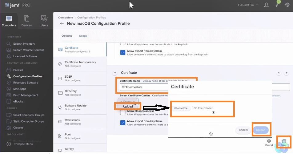

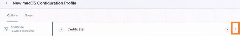

CERTIFICATE SETTING
Select Certificate
>>>Configure Certificate
Import Root CA
Upload Root cert downloaded earlier from Cloudpath.
Click on + to add more cert.
Import Intermediate CA
Upload Intermediate cert downloaded earlier from Cloudpath.

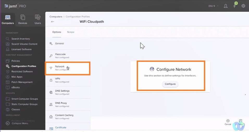

NETWORK SETTING

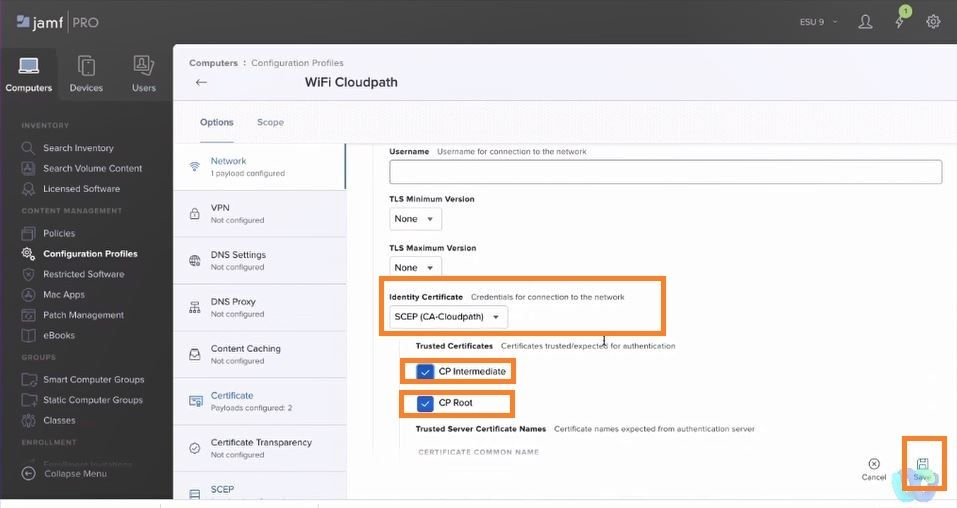

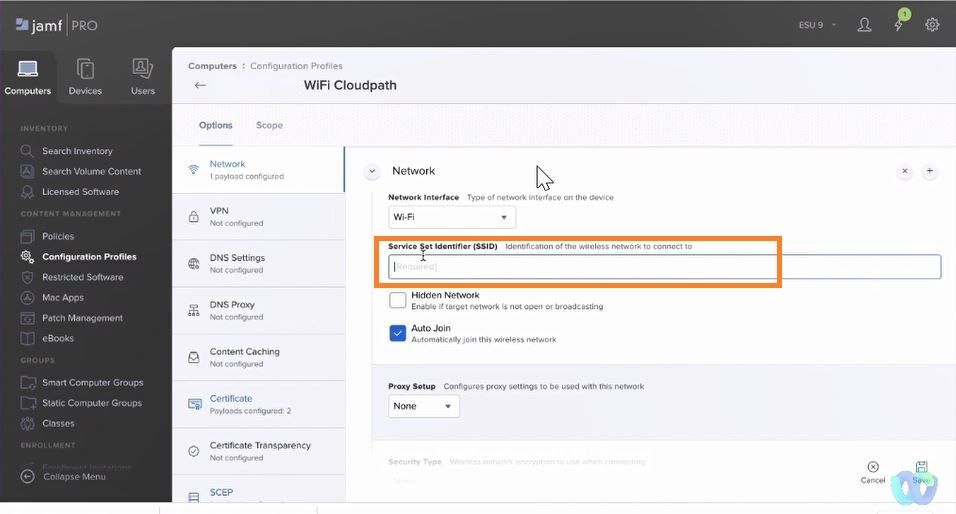

Network >>>Configure Network>>>Configure
Service Set Identifier(SSID😞 Name of the SSID

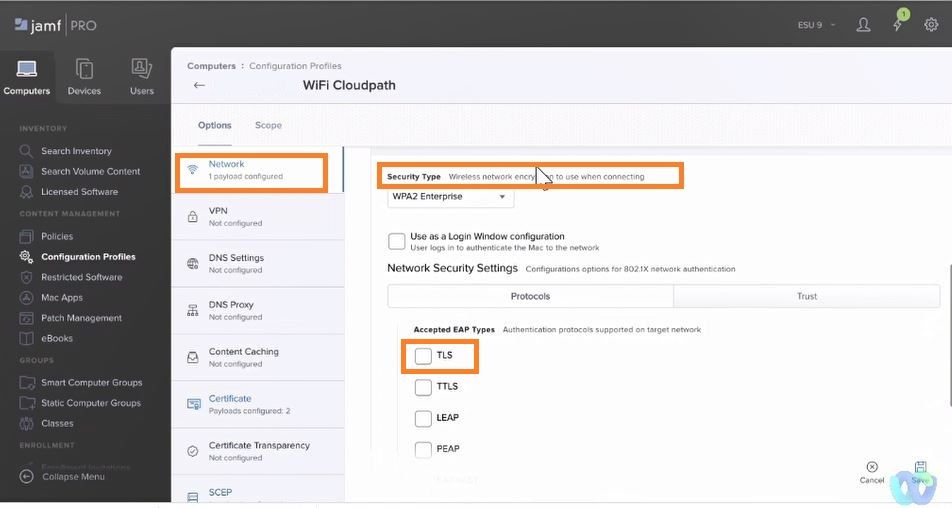

Security Type: WPA2 Enterprise
Accepted EAP Types: TLS
Select TRUST tab as shown in this screenshot.
Identity Certificate: Select SCEP profile created earlier.
Trusted Certificates: Select Root CA and Intermediate CA.
