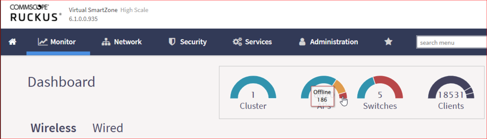

The controller's dashboard shows AP status and if we happen to find any AP which is not intended to be offline then below are some basic troubleshooting which we can run through.
AP will show with RED status in the dashboard:

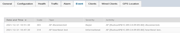

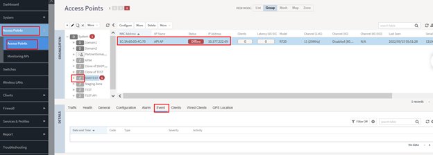

Login to vSZ GUI --> Access Points --> Select the AP which shows disconnected --> At the bottom panel click on Events Tab (as shown below)
Under the Events section, we will see SZ/vSZ generates event code 314 (AP heartbeat loss) and 303 (AP disconnect) once the heartbeat timer expires.
Heartbeat Interval:
The default heartbeat time is 30 seconds. The AP sends a heartbeat packet to SZ every 30 seconds as a form of a keepalive.
- If the SZ does not receive 2 consecutive heartbeats (60 seconds), SZ will generate a 'Heartbeat lost' message under 'Events'.
- If the SZ does not receive a heartbeat for a full 5-minute period (10 heartbeats), it will report the AP as OFFLINE in the GUI.

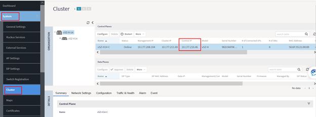

TIP: To find the controller’s CONTROL IP, login to the controller GUI --> System --> Cluster --> Control Planes --> Control IP.
