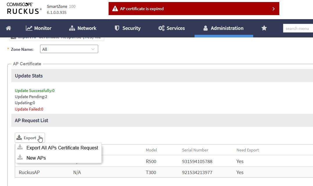

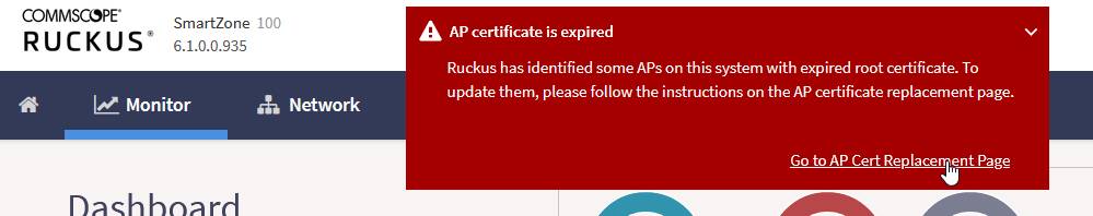

Why do I see the warning "AP certificate is expired" on my controller dashboard?
vSZ/SZ versions prior to the 3.6.x firmware release do not have AP-cert check enabled by default. Therefore, the APs that joined the controller before 3.6.x and were later upgraded to 3.6.x or above will display the following error message/warning on the controller dashboard.

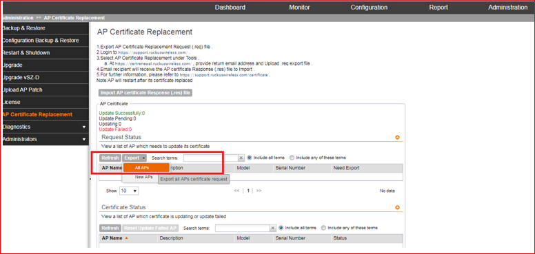

Export the All AP Certificate file from the controller (the below screenshot is from the older versions pre-5.x and 3.6.x): -

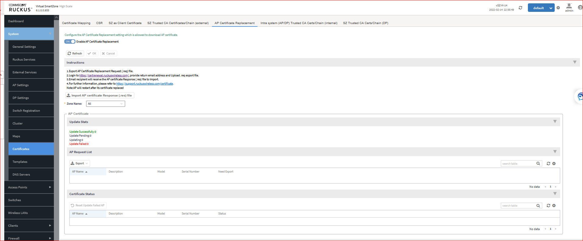

Here is a screenshot from the updated vSZ/SZ firmware version (above 3.6.x): -

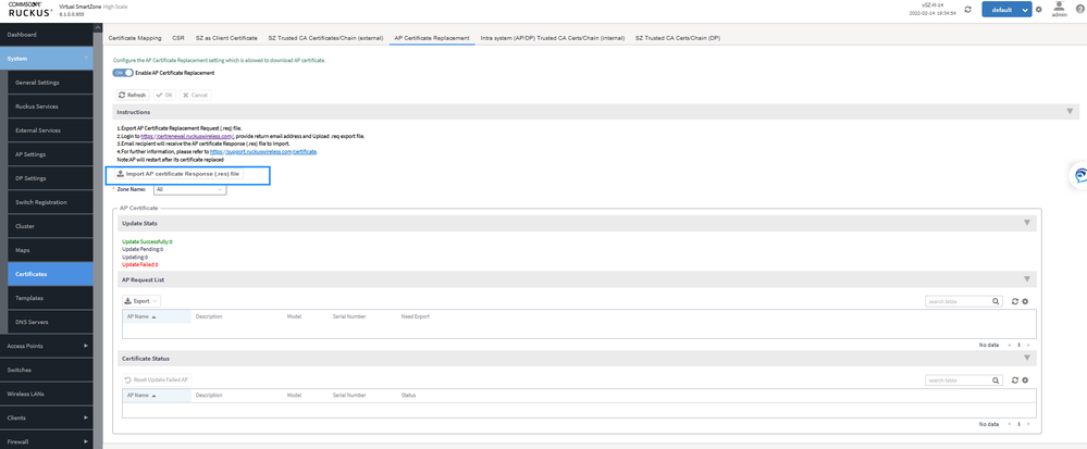

It displays the page shown below:
4. This process will take some time, and the AP will refresh its certificates.
