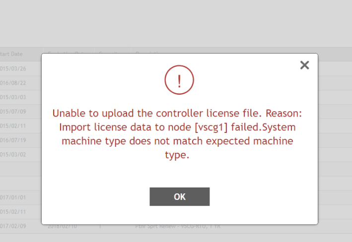

When we try to import the license file to the SZ\vSZ, we get the following error:
"Unable to upload the controller license file. Reason: Import license data to node [vSZ1] failed: System machine type does not match expected machine type"

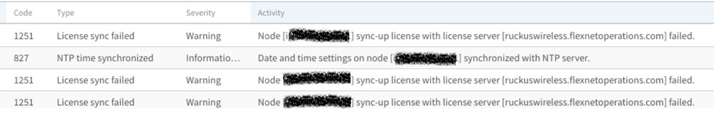

We see a license sync error on the events page as well.
