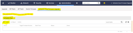

Follow below steps to schedule zone firmware upgrade on vSZ running on 6.1.1.0.x
Login into vSZ GUI>>Administration>>Upgrade >>Schedule Zone Firmware Upgrade
Schedule Task>> “+Create”

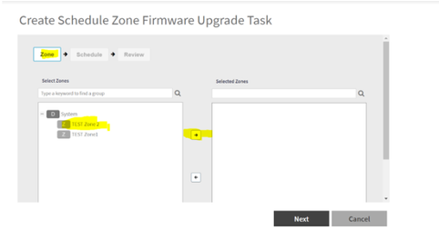

Select Specific Zone for the upgrade

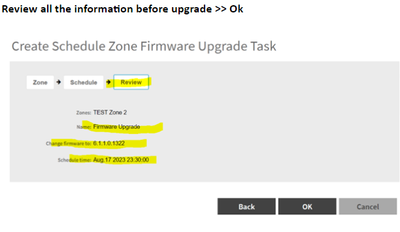

Schedule >> Provide Name/Change Firmware to(Select the version from the available list)/Schedule time( Mandatory fields)
Note : Time will execute at 0/30 min every hour (exp : 1:00, 1:30)
Review all the information before upgrade >> Ok
