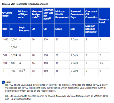

The vSZ resource requirements for the deployment will vary from the VM deployment type - Essentials or High Scale and the Virtual Platform – Cloud or on-premises
In case of a cluster with multiple nodes, every node is expected to have the same SKU or resource allocation, and it is not recommended to run multiple vSZs on the same VM hardware for high end deployment.

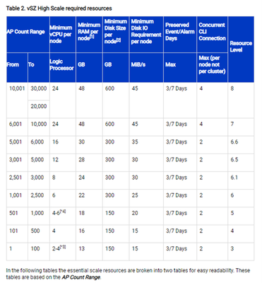

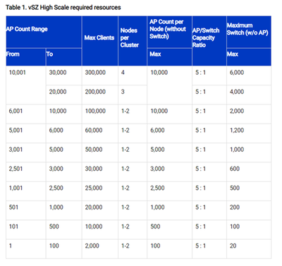

Cluster Scaling based on Number of APs and Switches:
Resource Requirements for on-Premise Deployment (based on SZ version 6.1.x):

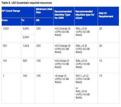

Resource Requirements for Cloud Platform:
Generic Notes:
Increase the vSZ total memory 2~4 GB when running on special or extreme deploy environment when vSZ raise a memory exceed (90%) alarm. For example:
Required Disk Type
If deployed hardware CPU computing performance is not good as recommended in 100 AP resource level, the 2 cores CPU setting cannot be supported. Upgrade to 4 cores instead of 2 cores in this case.
If deployed hardware CPU computing performance is not good as recommended Hypervisor (like Hyper-V) in 4-CPU setting to support 1000K AP, upgrade to 6 cores instead of 4 cores in this case.
The 6000 AP resource profile level could support to 4 nodes cluster. The total supported AP number will be up to 18,000 APs in a 4 node vSZ cluster.
One or more resources can be higher than the specified requirements. For example, if the instance requires 24Gb RAM, assigning 32Gb RAM is supported.
