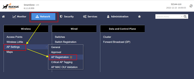

Below are the steps showing how to create a registration rule:

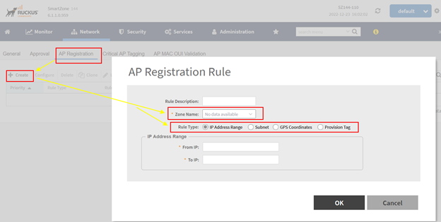

Login to the controller GUI --> Network --> AP settings --> AP registration --> Create --> Give a NAME to the rule --> Select the AP Zone on which you want the specific AP(s) to register directly --> Choose the Rule Type you want to use for this process:
There are various options available for the AP registration rule based on your requirement you can pick either of the Rule Type as shown below:
Note: If you have only 1 AP to move then you can still use the option for the IP Address Range and can give “From IP” and “To IP” as the AP’s IP (the value can be the same).
