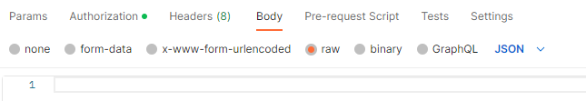

3. Go to Body, select raw and JSON format
3.1. Then, copy and paste within the Body this template for a PSK network example

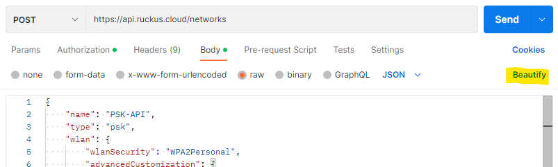

3.2. Click on Beautify to apply the JSON format to the template
4. Finally, click on Send to create the WLAN. To verify the results you can login into your Ruckus Cloud Portal and check the WLAN created, then select on which Venue(s) you need to broadcast it.
