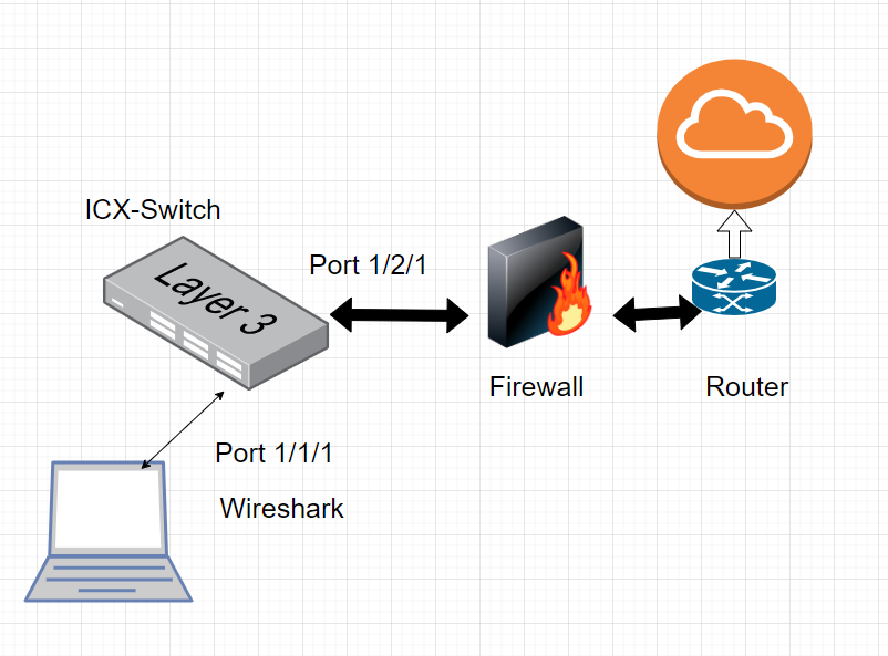

Here is an example using the given topology. Our objective is to capture traffic from port 1/2/1 and redirect it to an analyzer tool connected to port 1/1/1, where Wireshark is installed.
Device(config)#mirror-port ethernet 1/1/1 Device(config)#interface ethernet 1/2/1 Device(config-if-e25000-1/2/1)#monitor ethernet 1/1/1 both Device(config-if-e25000-1/2/1)#show mirror Mirror port 1/1/1 Input monitoring : (U1/M2) 1 Output monitoring : (U1/M2) 1
