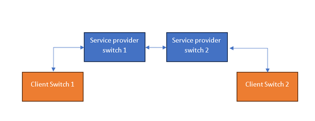

Topology:
Note:
- Service provider switch model is 7550-24 port model.
- Client switch model is a 7150-24 port model.
- Firmware version running is SPR8095m.
Configuration:
Client switch 1 Configuration:
vlan 100 by port
tagged ethe 1/1/2
router-interface ve 100
spanning-tree 802-1w
interface ve 100
ip address 100.0.0.2 255.255.255.0
Client switch 2 Configuration:
vlan 100 by port
tagged ethe 1/1/1
spanning-tree 802-1w priority 1
interface ve 100
ip address 100.0.0.1 255.255.255.0
Service provider switch 1 Configuration:
vlan 1000 by port
tagged ethe 1/1/3
untagged ethe 1/1/2
tag-profile 9100
interface ethernet 1/1/2
tag-profile enable
l2protocol dot1q-tunnel stp
l2protocol dot1q-tunnel lacp
l2protocol dot1q-tunnel cdp
l2protocol dot1q-tunnel lldp
Service provider switch 2 Configuration:
vlan 1000 by port
tagged ethe 1/1/3
untagged ethe 1/1/1
tag-profile 9100
interface ethernet 1/1/1
tag-profile enable
