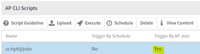

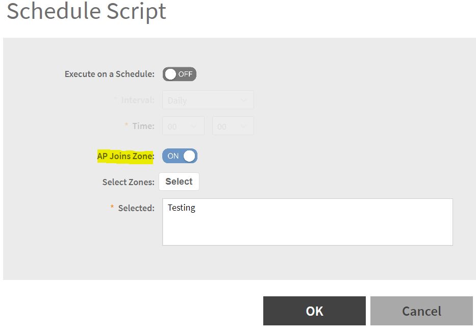

When an AP CLI script is uploaded to vSZ/SZ, the field "Trigger By AP Join" is set to 'No' by default and the script need to be executed manually(if it's not scheduled). However, if there is a requirement to have the script executed automatically whenever AP's join the vSZ/SZ, then please follow below steps.
Select the uploaded script >> Schedule >> Toggle "AP joins Zone" to ON >> Select the required Zone(s) >> Click OK to save changes.

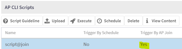

Now, the field "Trigger By AP Join" should be changed to 'Yes' as shown below and the script will be executed whenever AP's join the selected Zone.
