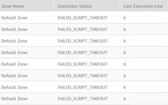

The AP CLI script feature on the Smartzone platform, has a limitation of timing out within 45 minutes of application on a zone. The symptom of the problem is as seen as below:

The problem typically happens when there's a high number of commands pushed to the APs, as seen below:

Steps to take:
In this case, simply create multiple scripts with three or four lines of commands each (or even lesser) and have them run on the v/SZ GUI one after the other, on the same zone with the large number of APs.
This has helped to eliminate the issue of script timing out and to have all commands applied through the CLI script feature at customer environment(s).
