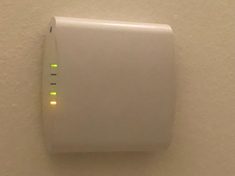

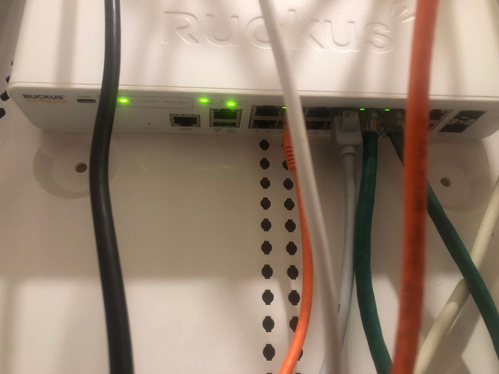

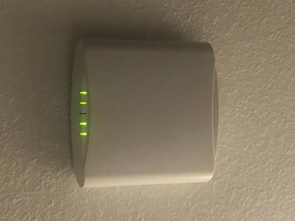

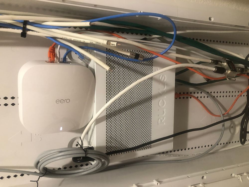

Sorry I found a way to upload the pictures, I needed to be logged in.
bad boxbad boxICX box eero wifi routerICX box eero wifi routerICX box lightsICX box lightsgood boxgood boxIMG_6899.jpeg
Hi @krivas33 ,
As per the case description, I understand that you are having slow connectivity issues after the power outage.
As per the light status I see from your screen shot, I see that the lights are in the normal state and we need to check few switch configuration details to understand the issue better and assist you further.
