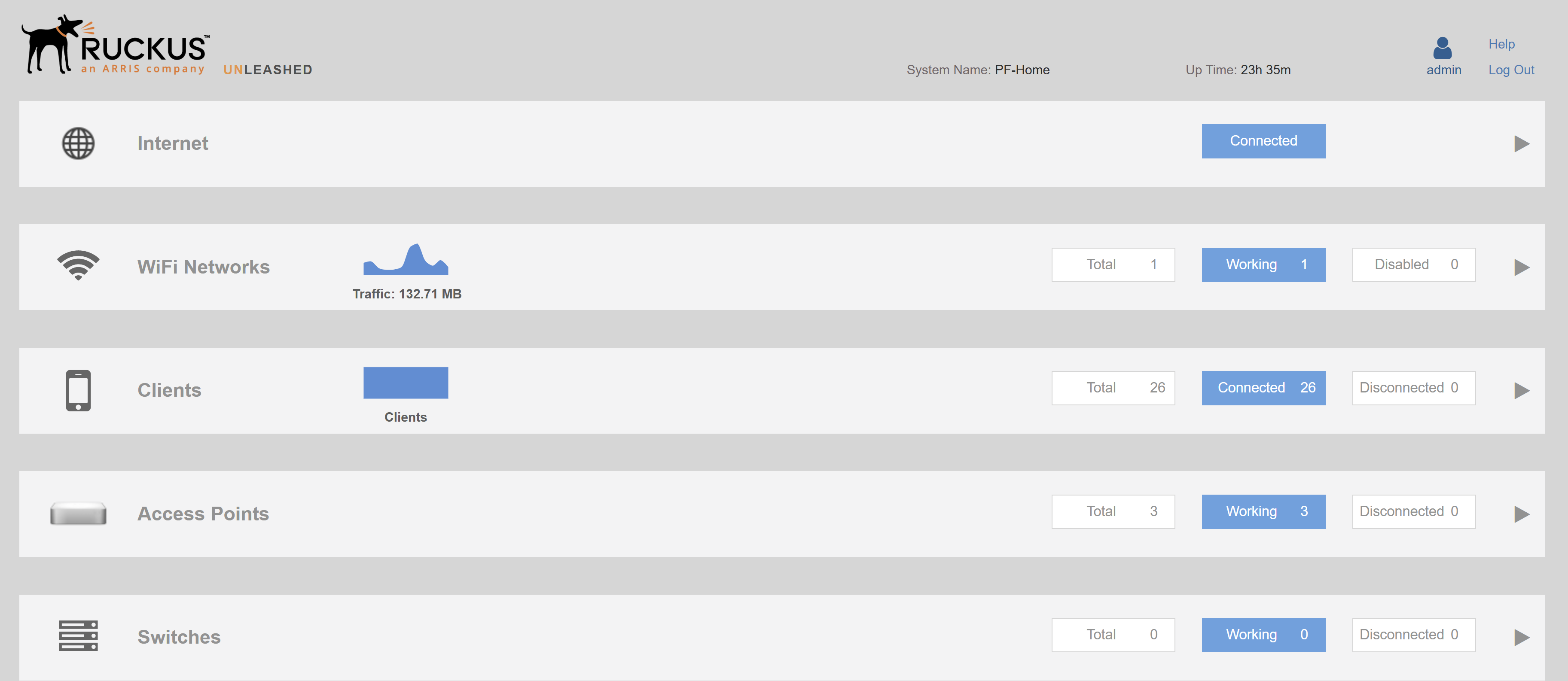

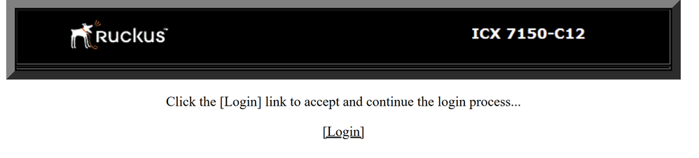

However, I still don't see the Switch in the ruckus portal (screenshot below), and I am unable to login to the switch portal (i tried all the passwords here). How can I login ? I saw somewhere that it helps to upgrade drivers (or something like that) and I can only do that using the switch portal

From the case description, I understand that you are not seeing Switch in the Unleashed system.

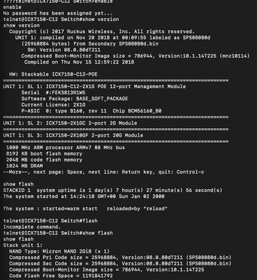

show version
show flash

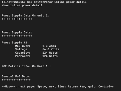

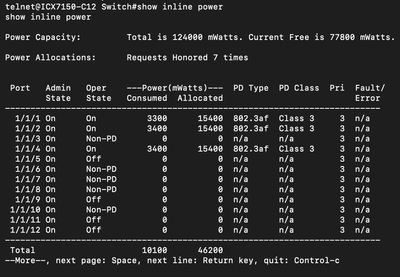

show inline power

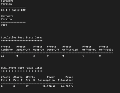

show inline power detail

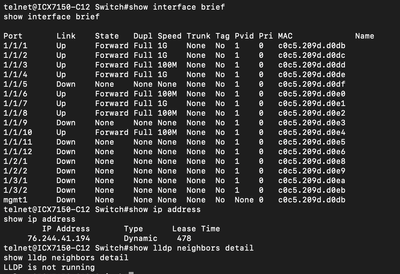

show interface brief
show ip address
show lldp neighbors detail

I was unable to see the switch IP via my LAN/IP scanner. Luckily, I could find the the switch IP on the AT&T smart home app. here is the output that you have asked for

Hello @pradeepgogu ,
From the response you shared, I noticed that the Unleashed admin portal shows 0 switches.
This may happen when your RUCKUS Switch is on an older version(08080d) which doesn’t let you log into the Unleashed application. We suggest you upgrade your Switch to the recommended version(8095g) to avoid this issue in the future.
Please follow the below RUCKUS Lennar Knowledge base self-help article which will help you to upgrade the switch to the recommended version(8095g)
Please follow the process explained in the article and let me know if you have any queries in this regard.
