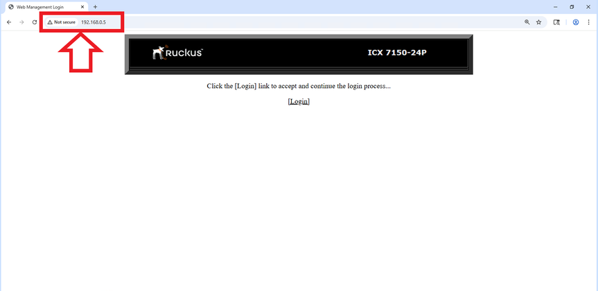

You should see a device named “Ruckus Wireless” in the list. Copy its IP address to the Web Browser URL.

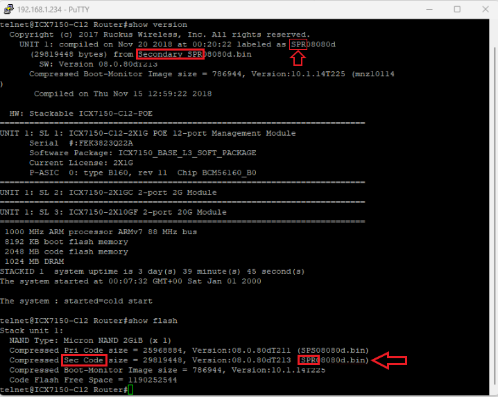

ICX7150-12P Router>enable
ICX7150-12P Router#show version

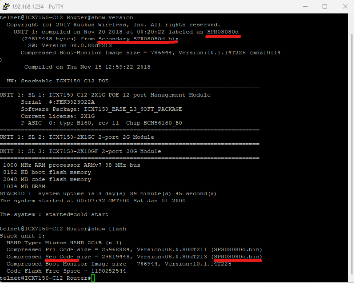

ICX7150-12P Router#show flash
If the output shows “SPR” anywhere in the software version (as shown in Figure 2), your switch is running the Routing Code, and it needs to be switched to SPS.
FIGURE 2 CLI: Command output showing Routing Code issue
