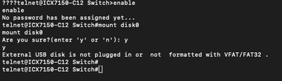

I tried the USB option and get this following error.
I checked and the files are loaded properly in the USB drive

Hello @pradeepgogu ,
Since you are able to access Mac laptop, the best option would be to use the USB method to upgrade the switch.
In the USB method, there is no need to use TFTP application.
If you’re able to copy the firmware to a USB drive and access it via the switch’s CLI, the USB upgrade method can serve as a reliable and efficient alternative.
Please follow the below RUCKUS Lennar Knowledge base self-help article which will help you to upgrade the switch to the recommended version
From the article, please use the second option (Upgrade using USB).
