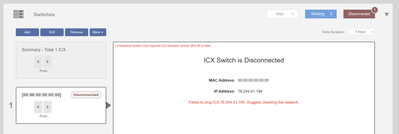

However, switch (after adding to the Ruckus portal), is still showing as Disconnected even after waiting for 1 hour
Hi - responding with the screenshot so that you know the current issue

I manually added the switch to the ruckus portal and it is showing as "disconnected". Although this looks like a minor issue, given I can access switch portal. I wanted to check how I can access switch in the ruckus portal

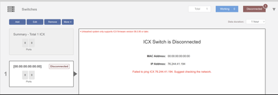

You may remove the Switch from the RUCKUS Unleashed system and add it back using the Switch IP Address, Username, and Password. Please refer to the screenshot below and the RUCKUS Lennar Knowledge Base self-help article for detailed instructions on the process.
