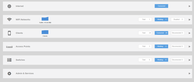

Unable to see the Switch in the Ruckus portal
pradeepgogu
I have been having choppy wifi and I fixed it recently using this link and huge thanks to this group !
However, I still don't see the Switch in the ruckus portal (screenshot below), and I am unable to login to the switch portal (i tried all the passwords here). How can I login ? I saw somewhere that it helps to upgrade drivers (or something like that) and I can only do that using the switch portal

I got hold of a windows laptop and updated the flash. see the latest version below
but, my ruckus portal still doesn't show any switch
Hello @pradeepgogu ,
From the response shared, I understand that the Switch is upgraded to the latest recommended version 08.0.95g.
Now, the Switch needs to be added in the Unleashed browser.
Please follow the below RUCKUS Lennar Knowledge base self-help article which will help you to add the Switch to the Ruckus Unleashed system.
https://community.ruckuswireless.com/t5/RUCKUS-Lennar-Support-Knowledge/Adding-a-RUCKUS-Switch-to-th...
Please follow the article and let me know if you have any queries in this regard.
