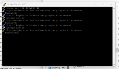

it asking me to:  Long In As:  what do I login as?
Ant
I'm getting this....
Ant
...and what is CLI...
Hi @Ant
Thanks for your response.
Please use the below mentioned credentials to login into putty.
Usernames:           Passwords:
admin                    sp-admin
super                     Lennar
                               lennar
                               ruckus
                               Ruckus!
                               Ruckus1
                               admin
                               password
Once you logged in please share the output of the following commands.
Show flash
Show version
