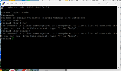

Hi @Ant
Yes, it is correct. Now please enter the following commands and share the output:
Show flash
Show version
Ant
i did, but nothing happened.  when i logged in, it did NOT show it saying: ICX7150 -C12P

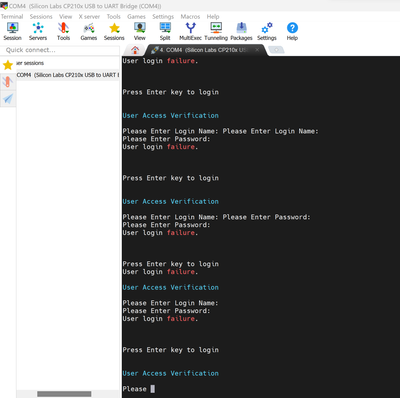

Hi @Ant
Please try to access the switch via console using the below guide and share the output of the following commands.
How to console in the ICX-7150-C12P:
Show flash
Show version
Ant
no, its not an accepted solution.  i'm getting this in the other one
