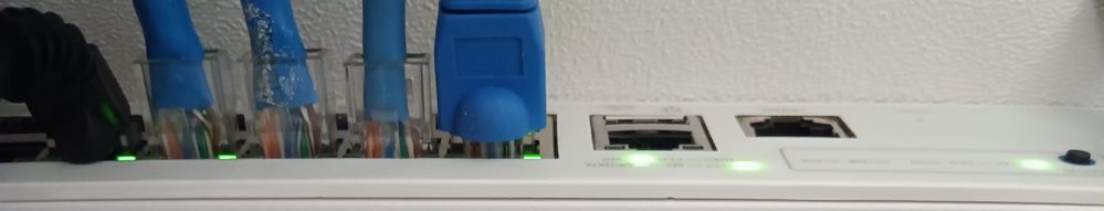

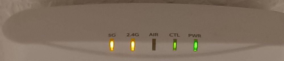

The new switch arrived today, cables connected and turned on. The switch PWR and SYST lights are green. The access point 5G and 2.4G LEDs are amber, the CTL is green and the power is flashing green. The web brower username and password are working. Unable to connect to the my SSID because it hangs at "Obtaining IP address..." and then "Disconnected / IP configuration failure" is the final error message. Below are the pictures.

Based on the description, the light on AIR is off and the light on the Radios 2.4 and 5g shows Amber when the WAP is configured but no clients are connected to that specific radio or WAP (the radio signal is on, but you have no devices connected (phone, computer so ion).
Please check the connection between the ISP router to the Ruckus ICX7150 Switch, because if this connection it's not working you will never get internet connection, just the AP will be powering up, because the Switch will provide power only. The yellow ports must be connected to your AP and your ISP router.

The AP and the ISP cables are connected to the yellow ports of the switch. The power on the switch was unplugged, plugged and the AP LEDs returned to the No Client status with the PWR LED slow blinking.
