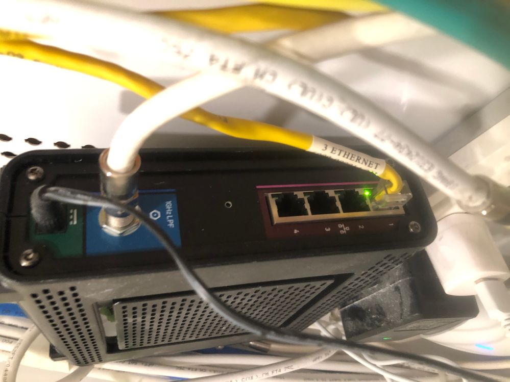

(Picture #1&2) Cable modem front and back picture, showing Cox cable into modem, ethernet cable in ethernet port then ruckus ethernet port.

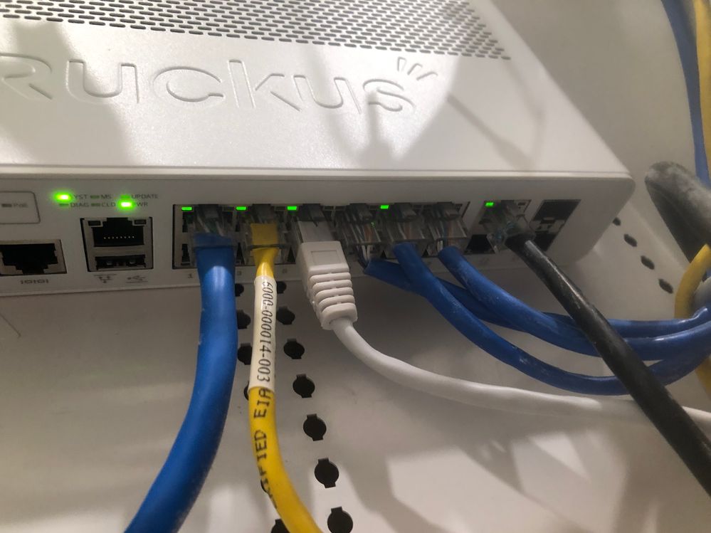

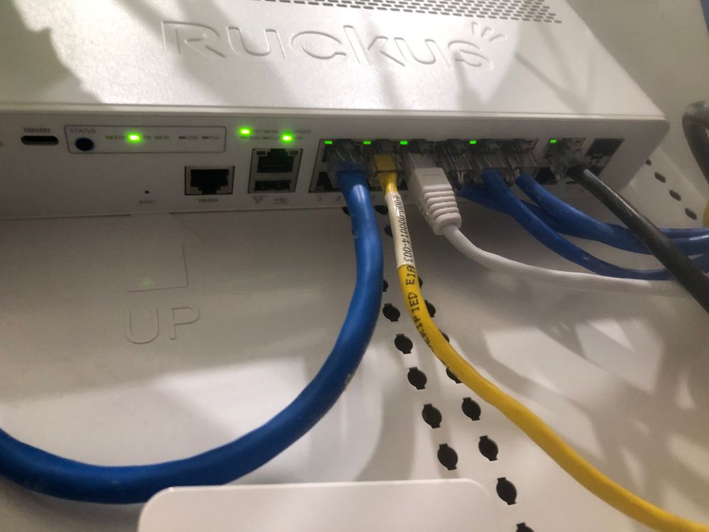

(Picture #2&3) two pictures of back of ruckus ports and lights
Blue fat cable on left is to AP unit
Yellow cable is to cable modem
remainder of blue cables go to each rooms ethernet port switch plates
White and black cables go to other ethernet enabled devices

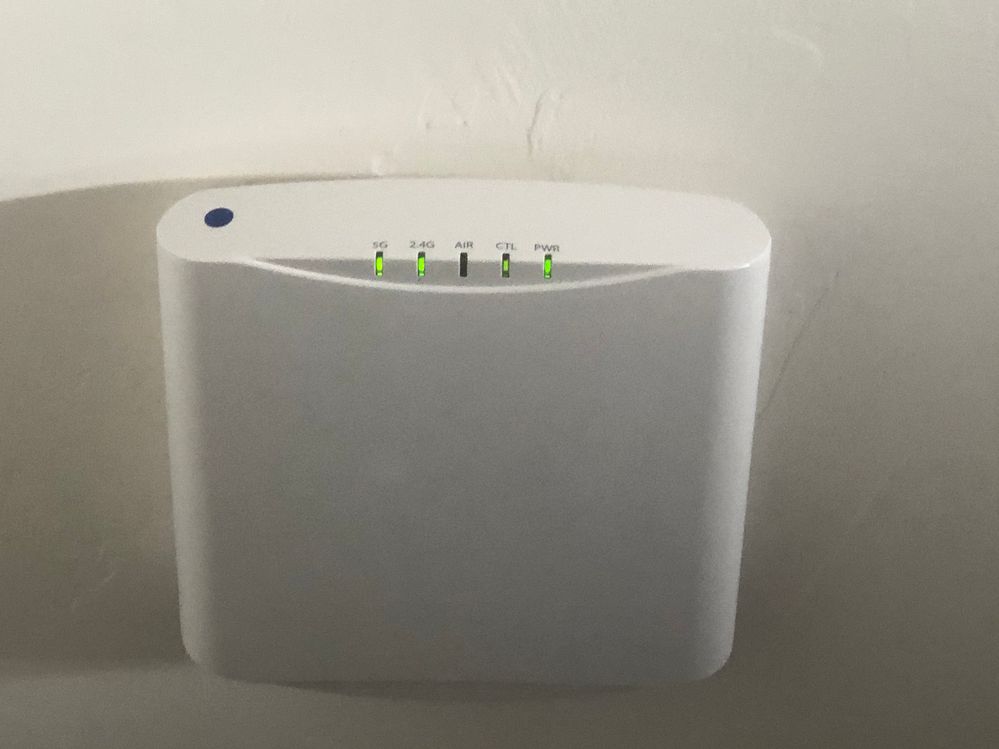

(Picture #4) picture of AP unit on ceiling showing lights

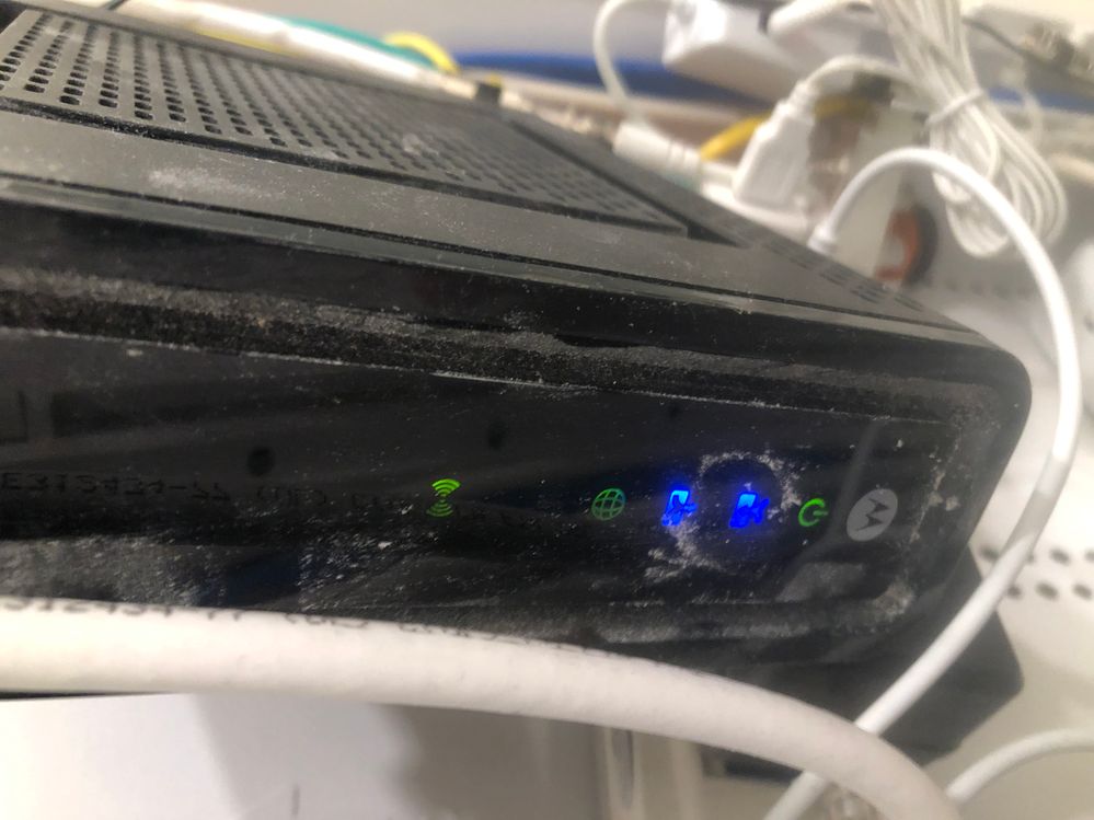

Original Motorola ModemOriginal Motorola ModemOrignal Motorola Modem BackOrignal Motorola Modem BackPic #1 of back of RukusPic #1 of back of RukusPic #2 of back of RuckusPic #2 of back of RuckusAP Unit on CeilingAP Unit on Ceiling
What's the switch? the Rukus unit?
Front of Motorola cable modem/wi-fi

White cable is to Cox connection, Yellow cable connects to ruckus unit
Fat cable on Left is AP cable, Yellow cable is connected to Cable Modem Ethernet port, other blue cables go to ethernet switch plates in rooms, white and black cable are other ethernet devices

From the pictures you shared, it seems like one of the ethernet cables is plugged into the wrong port on the Switch panel. It must be plugged into any 1 in-12 ports as shown in the below screenshot. Please unplug the ethernet cable and plug it into the correct port then reboot (unplug and plug from the power outlet) and try to connect to the Internet via Access Points.
It should be plugged into one of the 12 ports as shown in the below screenshot.

Yeah, oops that's my solar inverter internet connection ethernet cable, fixed.
