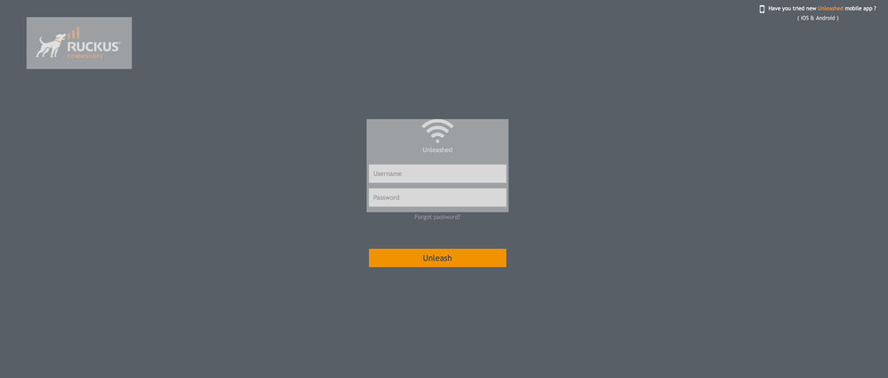

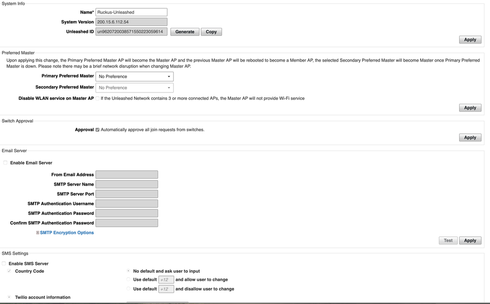

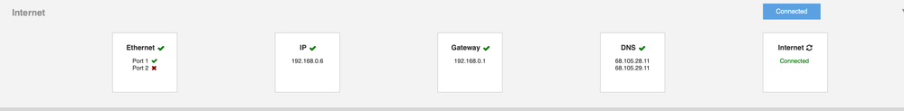

Finally figured out how to get safari to log into the ruckus configuration logon page. see attached pictures to see IP address and Rukus system version currently installed.
IP reboot/reset was done, but did not see the "configuration.me" wifi connection EVER, just reloaded into the Lennar wifi currently assigned.
