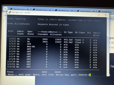

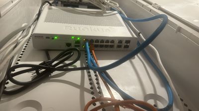

Already tried twice restarting the R510 from factory here some pictures . I’ll try to factory restart it again one more time following those steps.
Here some pictures.

Sorry I meant factory reset, I did unplugged and plugged back the cable and moved it from different ports in the switch and also did the paper clip process probably 3-4 times, but I’ll have to try without the other R510 connected since I did it with it connected. I’ll update you as soon as I get home and do the process again!
