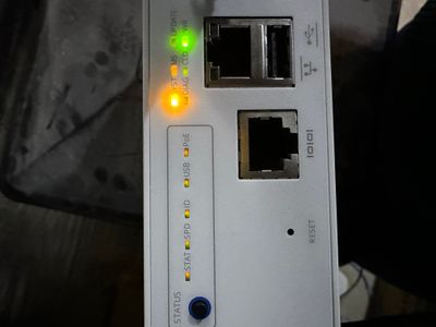

To be clear, after the factory reset attempts the Ruckus ICX 7150-C12P unit that shows a solid green light (PWR) and a solid amber light (SYST)

Hi @Mad-Lennar-Cust
As per the case description, I understand that your RUCKUS ICX-7150-C12P Switch is not working.
I see from the picture you shared, that there is an Amber and Green light on the Switch. That means the Switch is stuck in boot mode.
As you already tried rese with a paperclip. Please try it multiple times. If that doesn’t work, you have to perform the software recovery on the Switch.
