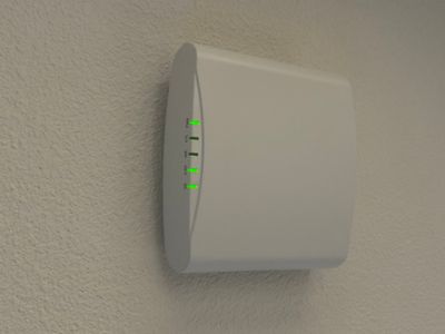

I own a lennar home, and my Ruckus unleashed isn't working. The 'CTL' light is off, I can connect to the WiFi, but there's no internet. Could you please assist me?

The CTL light should only be illuminated on one of the APs. The AP with the illuminated CTL light is the master AP, while the members should have that light turned off.
Now, concerning the problem, it appears that you are encountering a "Routing code issue," which seems to have started after a power outage.
